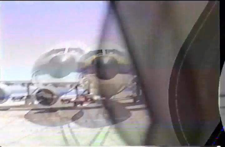

  1. Really don't know what to call this, but when I convert from a VHS camera through a USB dongle, to windows movie maker, the resulting video will go weird whenever the cameraman took a step and vibrated the camera. If you don't know what I mean, I'll post a picture of it, but it does not appear on the original recording. It almost appears as if the film is physically lifting off the tape head and becoming warped etc.
    Can anyone tell me what it is? I assume it's because of the deinteracing? The captured video is 25 fps instead of 50 fps interlaced, but the general smoothness is acceptable, it's just the jerking that's the problem. If the cameraman didn't shake the camera around, it doesn't even happen. Would it make a difference if I could record this at 50 fps instead of 25? Does anyone know of any capture software that doesn't automatically deinterlace? Thanks.

    I did see frames like this:
    Is that what you're talking about? That has been poorly deinterlaced and there's some kind of horizontal sync problem with the VCR or capture device.
  4. Originally Posted by jagabo View Post
    Yes, in that frame is exactly the problem. If the camera is plugged into a TV (even an LCD) that doesn't even appear.

    EasyCaps don't always do exactly that. But they are among the worst capture devices out there. A decent capture device costs a couple hundred bucks USD, better ones are twice as much, really great ones run into 4 figures. What do you expect for ten bucks?
