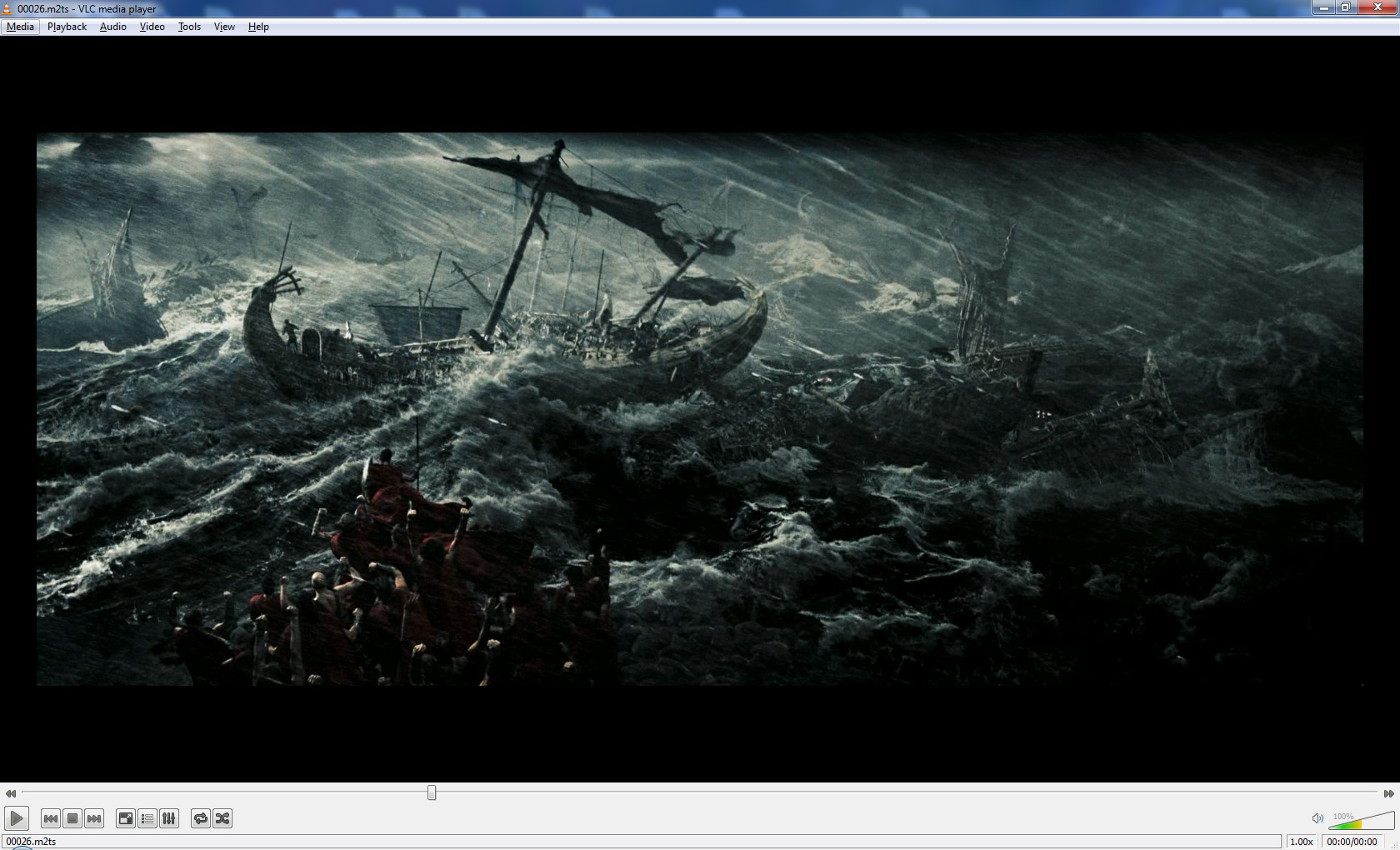

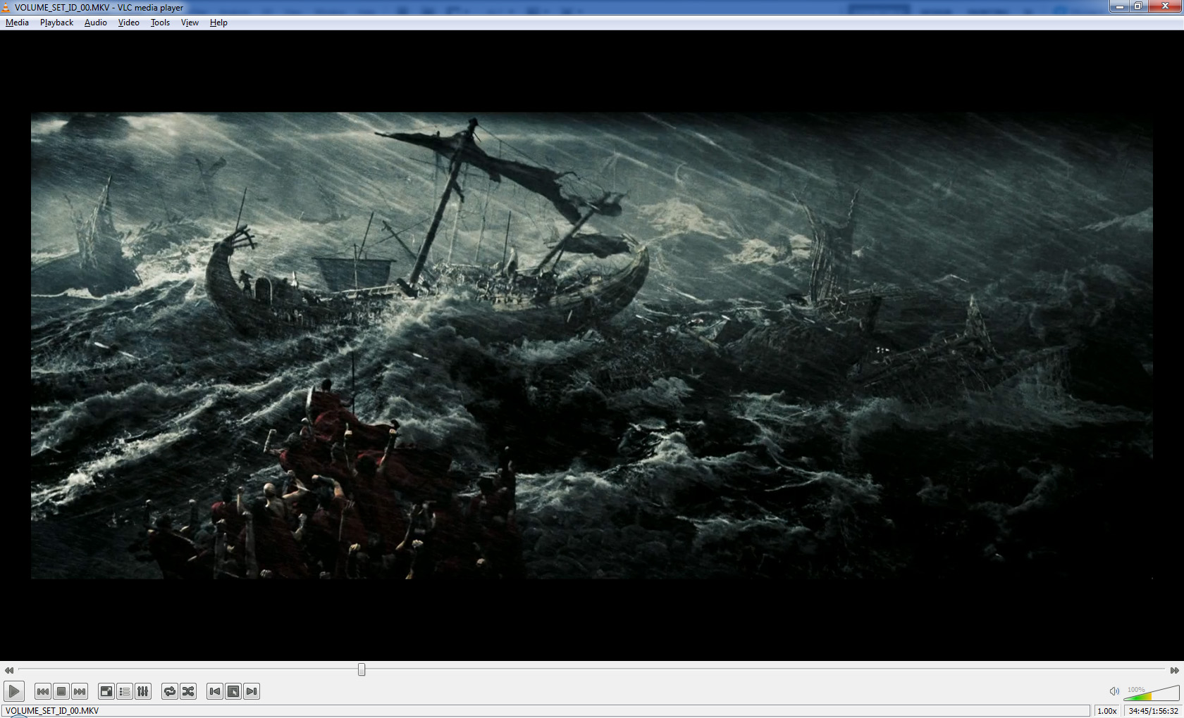

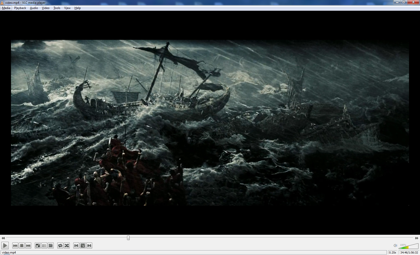

I've recently started to backup my blu rays, to play on my WD live. I want the best quality but a decent size, say 2-5GB. I started out with my copy of 300. I used BD_rebuilder, RipBot, and Handbrake to compare different qualities. After playing with the settings a 1.9GB file looked as good as my original 4.4GB try with RB_R.
Then I decided to see how good a video from a pirate website compared with mine. I download one from a 3Li user. I was BLOWN away! His 2.2GB file looked almost as good 23.2GB original BD!!!
Don't believe me? here are the images that show just how good his are.
I'm on a quest now, just as you Metroidn1f, how can i make mine look this good? I've emailed him but he has yet to share. The original is a 1080p, and the other two are 720p. -
You're assuming that denoisers and sharpeners are all that's being used. It looks more complicated to me. The darks are crushed and the video looks oversaturated, not just denoised and sharpened. Learn to use color and level controls; lower gain and gamma until the darks are crushed below RGB64 or so and start climbing against the left-hand side of a histogram as in your images, and the lower midtones are darkened until they look almost oil-painted. Increase saturation. You'll have to control the extreme brights a bit to prevent total blow-out. Sharpeners and denoisers alone won't get the effects you're looking for.
