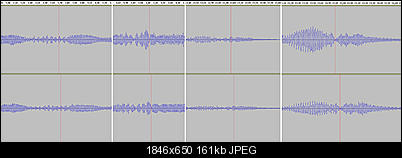

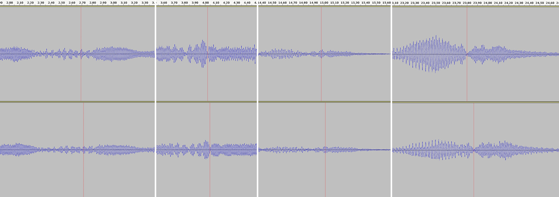

    The only tool I've got is audacity, and this is just a quick observation from staring at the waveform; the right channel seems consistently behind the left channel. At 7 seconds in, the right track is delayed roughly 35ms. At 18 seconds in, it's roughly the same. At 24 seconds it's delayed by nearly 70ms.
    To make things easier to see, I split the L/R channels, normalised both, applied a lowpass filter cutting of at around 90-150Hz. After doing this, the offset between the tracks is visually quite obvious. I'll post some example images this afternoon.
    I don't know where you'd go from here as I'm not up to speed on the best commercial software to fix this kind of problem.
    TBH, I would've thought an advanced sound editor would be able to line the tracks up by analysing the amplitudes of the waveform and shifting one relative to the other until there's a minimum difference between them. It doesn't seem that difficult/complex (famous last words).
    May 2006
    United States Of America
    Well I have Audacity but much prefer Audition. Maybe Audition 6 has that ability but I'm "stuck"/more comfortable with v3.
    Oct 2010
    England
    Filtering out everything but the low frequencies makes the differences obvious:
    It would be really helpful if there was a way to make the edits using these filtered versions as a guide and have the changes automatically applied to the originals - while simultaneously making sure the edits happen at zero-crossing points.
    I can't figure out a practical way of doing this yet...
    Trying to trim visually with the originals is too difficult.
