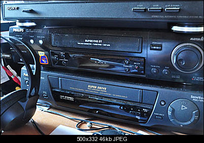

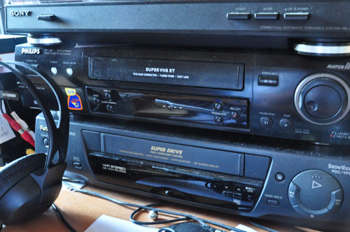

    Yes....please ignore the guy who often connects his S-VHS, standard VHS and even a turntable(with no amplifier) to his computer via a small USB capture device(Hauppauge). Today it is the turntable.....3 albums recorded, edited and burned to CD so far today.
