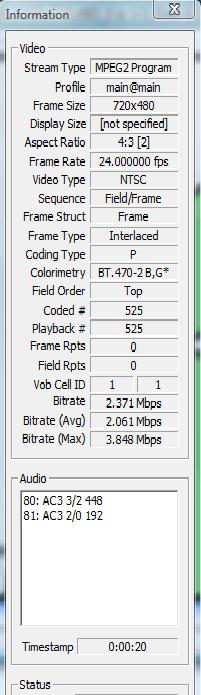

  14. Did away with script, went back to DVDRebuilder Pro frameserved to filtered VirdualDubMod. Did an interlaced PAL to NTSC yesterday, complete with menus, audio options, etc. DVDRebuilder Pro is not only a one-click program. It encodes with Avisynth, so is very flexible. It has many features for advanced users. After setting up parameters and frameservers, one pass through DVDRebuilder Pro created complete compressed NTSC DVD. It is not difficult to do, especially for a main movie only DVD. You do have to frameserve all vob's during processing for a complete DVD. The one I did had 50 open frameservers! Took about 30 minutes to set everything up. VirtualDubMod filters deinterlaced and changed the fps and aspect ratio. DVDRebuilder Pro did the rest. I used VOBBlanker to correct the aspect ratio data in the vob's afterwards.
    Will test in a couple DVD players and post back.

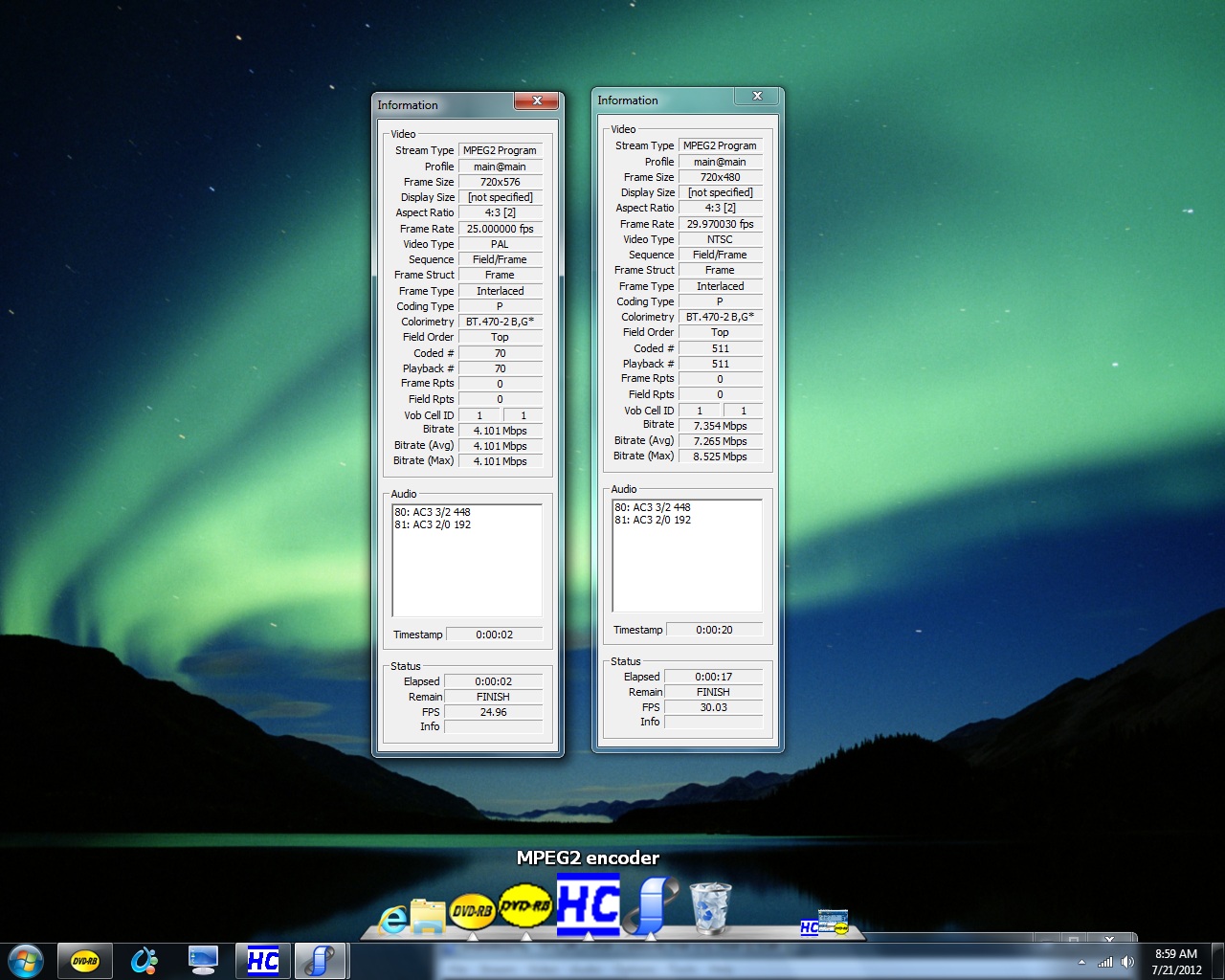

  22. I did read the guides and do know how to re-encode and re-author, but wanted to create a simple, fast solution.
    DVDRebuilder Pro v1.28.2
    results for interlaced 25fps PAL to interlaced 29.97 NTSC with menus and features intact.
    The menus may be "non-compliant", but the VOB's are converted to NTSC and the menus, subtitles and features all work. My only interest was to convert a PAL DVD to play on my NTSC only player without re-encoding separate files and re-authoring . I have only tested with an animated DVD that was only available as PAL. Different Avisynth filters may be necessary for a regular movie. I was unable to reencode with DVDRebuilder v098.2 (Free) due to audio issues.
    Extracted full disk with DVDFab
    Altered HC.ini file (in programs folder) to generate all VTS files (not just the large ones) with:
    [Options]
    VTS Minimum Size Re-Encode Threshold
    vts_min_size=0
    Range:0-?, Default: 25625 (~52 MB)
    Encoded with CCE in DVDRebuilder Pro v1.28.2 with following script in the Filter Editor:
    ConvertToYUY2(interlaced=true) #Probably unnessary - (I sometimes frameserve from VirtualDubMod).
    # Smart bob to get 50fps video
    sbdeint()
    # Gamma on PAL content is generally 20% higher than NTSC,
    ColorYUV(Gamma_Y= -43)
    # ChangeFPS duplicates frames to reach the desired framerate
    ChangeFPS(60000,1001)
    # Separate new frames into fields
    Separatefields()
    # Alternate keeping the top field from one frame and bottom field from the next
    SelectEvery(4,0,3)
    # Resize fields to NTSC-compatible size
    Lanczos4Resize(720,240,0,0,720,288)
    # Weave fields back into interlaced video
    Weave()
    DVDRebuilder has audio sync problems when changing frame rates. Remuxed and corrected sound sync on only the main title set (multiple VOB's). Smaller title sets appear to be ok. (If problem, remux them too.)
    Demuxed selected title set with DemuPgcDemux_1205_exe
    Muxed with muxman_0_16_8
    Renamed new VOB's to match DVD and overlaid into DVD folder.
    Ran FixVTS1.603 (full dvd) to repair structure and "adjust your DVD files into better DVD compliance"
    Changed Video Manager Menu and title set(s) attributes from PAL to NTSC 720/480 Letterbox with IfoEdit.exe
    Burned, everything works on my Pioneer player.

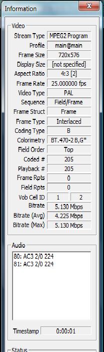

    Attached are before/after Dgindex screens. I also confirmed file data in VirtualDubMod, VLC and VideoReDo. I won't discuss menu compliance (VMGM_MAT in IfoEdit shows "TV system NTSC 525/60"), as I have no experience with menu editing, but this method allows one to use their desired AVS script, select content and encoder thru DVDRB and quickly process a complete DVD. Aside from DVDRebuilder (you can run v1.28.2 unattended with "One Click Mode"), everything else is straight forward and takes about 10-15 additional minutes.
    It's fast and simple, but may or may not work for you. Its advantage over just changing the DVD video attributes with IfoEdit or VobBlanker is that you can avoid re-authoring and encode the complete DVD to NTSC size and frame rate with any Avisynth filters you desire. If you have DVDRebuilder, it's worth a try.

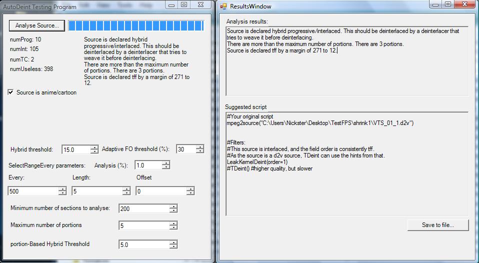

  24. What? The source is interlaced. Dgindex says it's interlaced. Frame by frame in virtualdub shows it's interlaced. So the converted is interlaced. How do you convert an interlaced video? By changing it to pseudo progressive? If it were progressive, I would have changed to 720x480 and used dgpulldown to change pulldown from 25 to 29.97 - much easier.
    I didn't say the menus were "all messed up". Quite the contrary. It plays perfectly. The video is smooth. The menus work perfectly. The subtitles are fine. The audio is fine.
    (I changed my method because it is easier to use Avisynth filters and I wanted to increase the frame count by Bobbing..) And............the earlier one plays fine too.

  25. Originally Posted by nicksteel View Post
    Got a sample from the source? Earlier you said it's an animation. Almost by definition animations aren't interlaced.
    Now go explain your method in the DVD-Rebuilder Forum at Doom9. There'll you'll encounter the developer, jdobbs.
    That means nothing. It only says how it was encoded and nothing about what the source is like.
    The only way I know how to determine if a video is interlaced is to load into VirtualDub, go to a motion sequence and visually detect it.
    Even seeing the interlacing can be deceptive if the fields are phase-shifted, or it's field-blended from a bad NTSC to PAL conversion.
    This fps change does definitely screw up DVDRebuilder muxing. I get around this by later remuxing the entire title set, not by video segment.
    Which is why it's easier (and faster, and with better quality results) to do it yourself manually.
    ... even the chapters survive
    Just not in the same places since the source chapter frame numbers are from a 25fps source, and the output is 29.97fps. I'm having a little trouble picturing how the chapter frame numbers are automatically increasing by a factor of 29.97/25=1.1988. Are you editing the celltimes.txt yourself? And, once again, your subs aren't the same as before. They may be useable, but the BMPs are still 720x576. The subs are larger and located differently on the picture. That can all be fixed, of course, just not within DVD-Rebuilder.
    No one says it can't be done. Converting videos from PAL to NTSC is trivial and one doesn't need DVD-Rebuilder for the job. It's the menus that are the hard part. And even they can be fairly easily converted if you convert the motion menus and static menus yourself for use in some authoring program that adds in the sub-pics and buttons and menu commands.
    If you did it within DVD-RB, then more power to you. I didn't think you could. And you didn't, really, since you had to do a lot of fix-up work afterwards. If you can do the job with the help of DVD-RB, you can also do it yourself, completely manually.

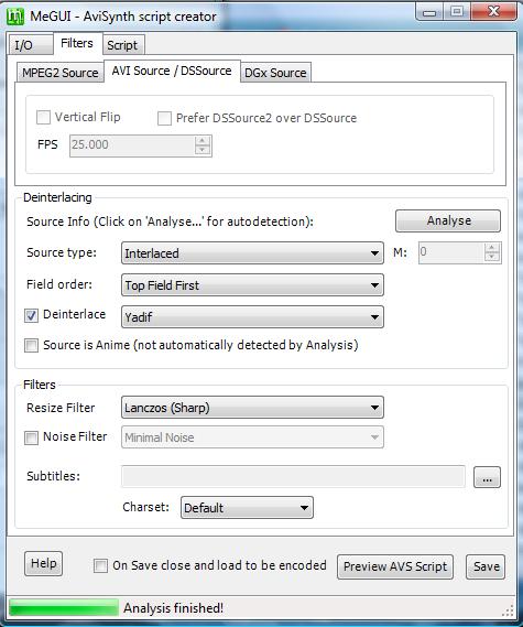

  28. I ran MeGUI, which has source interlace detection analysis. (attached)
    Also ran SourceDetection.exe, an older less accurate precursor to MeGUI's detection analysis. (attached)
    AVISynth advises use of MeGUI's analysis, as SourceDetection.exe is outIdated and not updated since incorporation into MeGUI.
    Only post DVDRB fix-up was remuxing one title set with multiple vobs. 10-15 minutes max. Remember, this is only an expansion of patching a DVD in IfoEdit to allow playing PAL on a NTSC player. All I am doing is re-encoding the VOB's for size and fps. Nothing else. Just a fast and simple way of converting interlaced PAL. I've only done this one DVD. I would have to do several be confident in the method and only offered it for others to try.
    Thanks for your advice on chapters. Fps change obviously has affect.

    Even if were progressive, I would use an AVS in DVDRB to change the size and then run pulldown on the M2V's after encoding and prior to building in DVDRB. No fps would be changed, no remuxing would be necessary. Would then use IfoEdit to patch.

  29. MeGui's analysis is pretty much useless for some sources. I would never trust it for anything at all, least of all for the kinds of sources with which I frequently work (field-blended from bad PAL to NTSC conversions).
