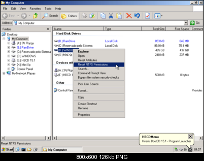

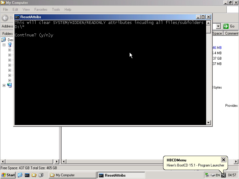

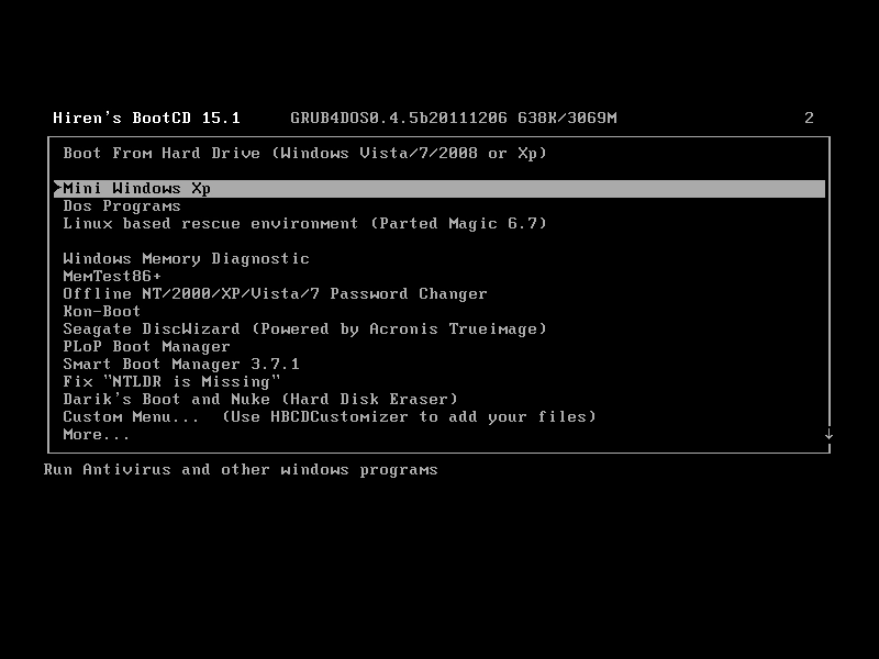

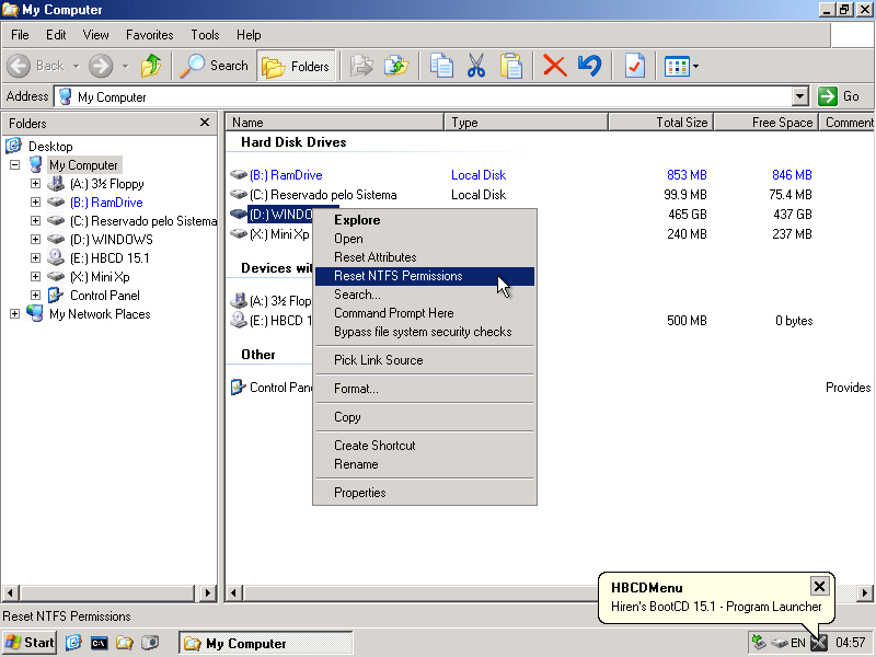

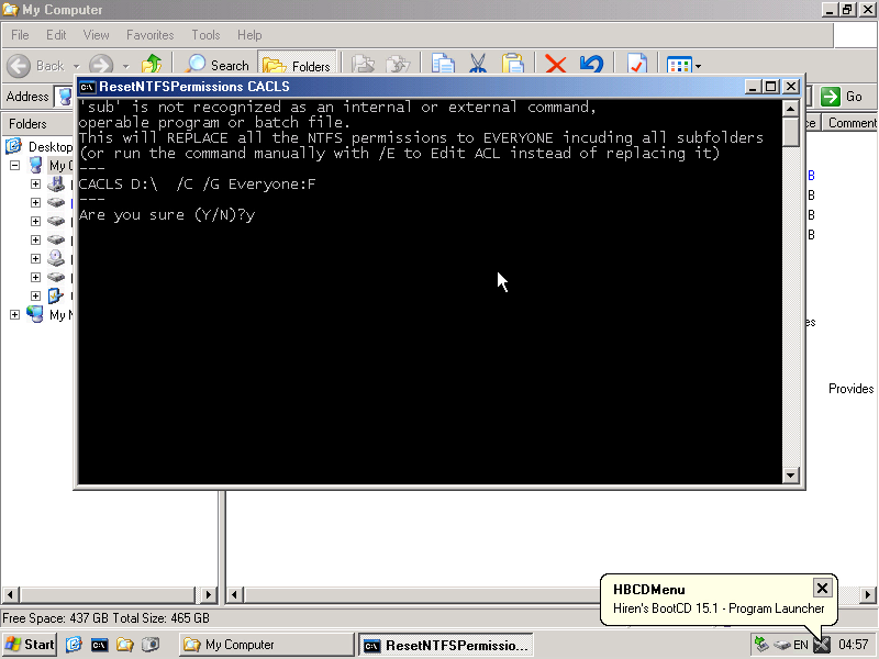

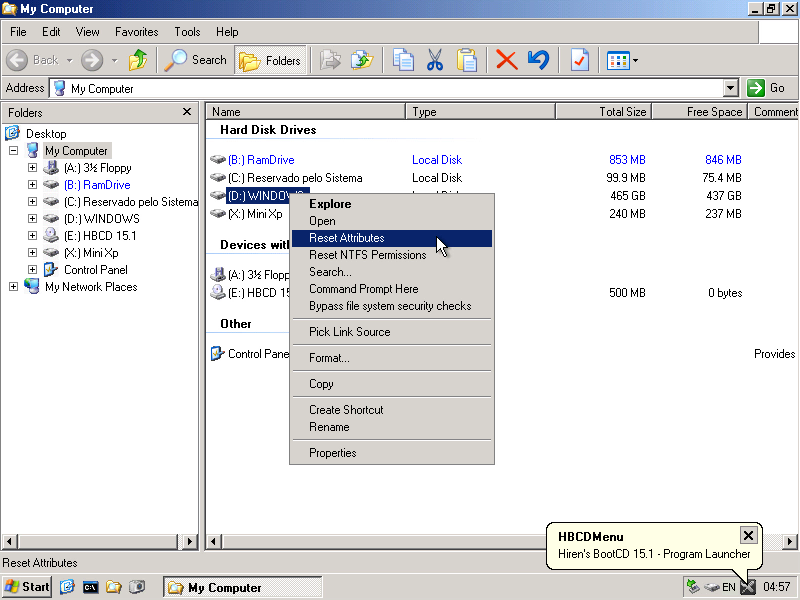

  17. Lone soldier Cauptain's Avatar
    Jan 2006
    Brazil
    [QUOTE=Ennio;2172548]
    Originally Posted by drjtech View Post
    I am coming from XP and take some things for granted. Windows 7 is pretty new to me. For example I found out the hard way that both analogue - and digital output don't work simultaneously (I solved that issue btw).
    Can you guys tell me some more other crazy things to watch out for?

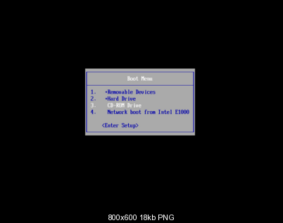

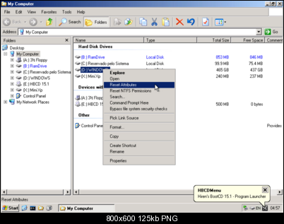

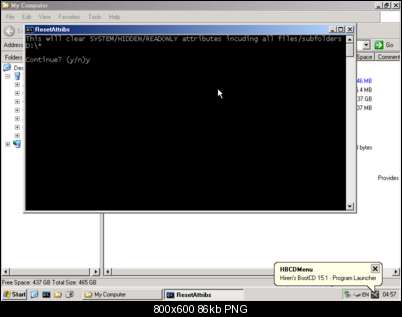

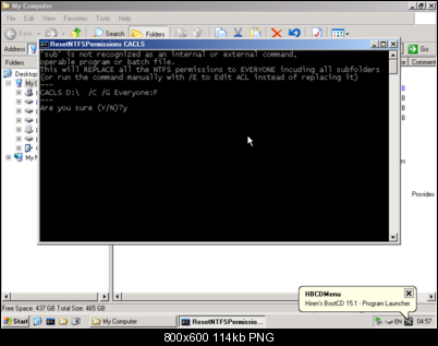

    1 - Dowload Hiren Boot CD 15.1
    2 - Boot your HBCD on PC.
    3 - Looks the screenshots below:
    4 - Reboot. Try & reply.
    Claudio

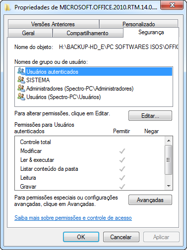

  19. Lone soldier Cauptain's Avatar
    Jan 2006
    Brazil
    Originally Posted by Ennio View Post
    Thank you Cauptain,
    As I try to understand your screenshots, maybe there will be unwanted consequences in eg. user-interfacial lay-outs or introducing possibilities like accidentally editing/deleting system files/folders.
    Before I try this, can these changes made undone again should I want to?
    Cheers
    Ennio

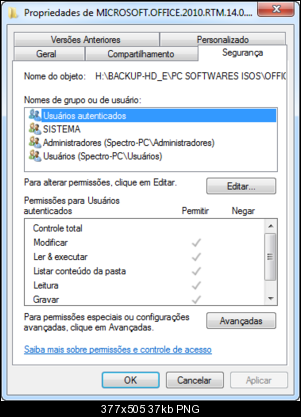

    Yes. You can.
    Before any step, go to properties and print "all users", after this if you need, only named 'all users" again.
    Claudio
