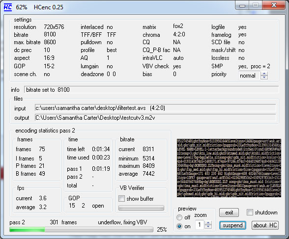

  1. Hi there, so I've been re-encoding a DVD .m2v demuxed stream, avisynth filtered and all.
    I have come across the problem as in the title in a very specific part of the film.
    The scene is very simple essentially black screen with some white text, then some flashes of orange so this should be fairly easy to encode, but I'm guessing due to this, the VBV buffer is getting very low. HCenc will just die on me at this point. I've tried things like raising average bit rate, increasing minimum bit rate, increasing bit rate for selected section of the frames in that section, but i seem to get the buffer underflow (almost) regardless. I found that lowering the Adaptive Quantiser to zero seems to fix this problem. Is this a valid fix? Or is there something else I should be changing instead.
    If need be I can encode the entire film in sections to the chapter breakpoints with closed GOPS and then re-encode this specific section with different settings.
    I've attached a screenshot of settings. I can make a sample video on request but it will take me a little time.
    I'd also like to state that I'm going for highest possible quality encode. Any recommendations would be welcome regarding settings, bit rate etc. For example, the original video averaged about 8250 and had 1.5kbps DTS stream+ small AC3 stream. So I've kept inline with this. However, calculators seem to say 9.8 - 1.5-0.16 - overhead should be around 7800kb/s. Am I pushing my luck?
    I chose FOX2 matrix on a pretty poorly informed intuitive approach but from the lower numbers in the matrices, I was assuming some sections in the film which lack contrast and look pretty washed out, would benefit from it. There isn't all that much motion though, it's only frame by frame drawn anime. So I think maybe the matrix (from action shows i believe) is not 100% optimal. Just doin what I can for best possible image quality while remaining under 9.8mbps.
    Capacity is a DVD-9 so I have plenty of space for a 86minute video.

    Hi again manono, and I'd like to say thank you for all the help recently
    However, conceptually why does the buffer UNDERflow when bit rate is high? Have I got it the wrong way round thinking that too high a bit rate would cause a buffer to OVERflow i.e. the buffer cannot deal with the amount of information coming in?
    And regarding bit rate, say all streams excluding video come to 2mbps. And for simplicity, lets call the max 10mbps combined. Does that mean my MAX bit rate should never ever exceed 8mbps? Or is there some leeway from buffering and also if the audio-streams are variable bit rate, won't my re-encodes (which have smoothing/denoisers) follow a similar pattern of bit rate rise and falls of the original source therefore not exceed 10mbps combined as long as I keep the same average/max of the original source (I know that changing quantisation matrices will invalidate this somewhat as well, but I'm interested in the theory as well). Can their ability to encode all the audio streams + average 8.25mbps video be explained ..because they encoded both the audio and video streams at the sametime and made sure the total bit rate never exceeded 10mbps?
  7. So I've tried 0.26 beta. As well as arbitrarily setting the bit rate to low to very low values. I still get the buffer underflow. Infact, it reaches critical even sooner when I set bit rate to 2000kb/s
    edit: If I push the bit rate to 10mbps, it manages to fix the underflow and carry on...

  10. Cornucopia:If you're encoding with hcEnc, are you using a default settings profile? or are you starting with a default profile and customizing those settings? If so, try NOT customizing (except the bitrate).
    Thanks, this piece of advice did the trick. Obviously I was attempting to optimise my output quality. But it actually seems the main problem was the Scene detection options. If I have it disabled, I have to raise my bit rate (at least the max bit rate) to levels which are outside DVD spec/feasibility. To be honest, I doubt this is how it's supposed to function, closing the GOP on a detected scene change (except for some freaky marginal case) shouldn't suddenly fix all the issues. But there we have it.

    Also, you're just encoding a small portion of a video, only 302 frames? You might have better luck encoding a much longer video. In fact, if you're opening that slow script in HCenc, I think I'd make a lossless AVI from it in VDub before then feeding that into HCEnc via an AviSynth script and AVISource.
    I picked out the small number of frames because it's not fun testing with an already cut down section which takes over an hour and a half to encode at 4fps...(my previous script used to do it at 10fps...but I guess the super sampling killed it)
    I picked the 302 around the problem area- giving it enough frames beforehand to "calibrate" the VBV buffer to go into the problem area correctly to reproduce the problem. I may have an "unofficial" look into some other encoders but I'm fairly happy so far with HCenc though I will have a look at converting to uncompressed AVI. Hopefully 250gb of HD space(all I have left) will be enough.
    So final setting wise I calculate my hardlimit to be 9.8 - 1.5 - 0.16 = 8.14Mbps
    An average of 8 or 8.05 is inline with the kind of headroom the italian release gave. But the max spike bit rate still confuses me slightly. It seems I can push it up to about 9 and intuitively I assume the encoder must keep track of the VBV to buffer these high bit rate spikes during lower activity previous frames i.e. giving the maximum possible quality. Obviously this is a posteriori information so it comes from the multiple passes required to encode it. This is the only way I can imagine the DVD spec being followed.
