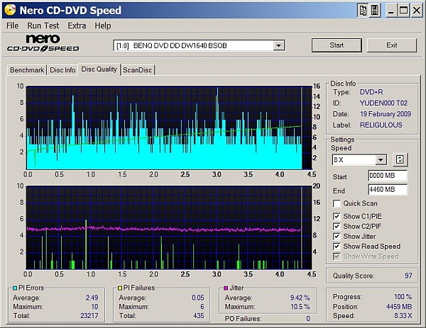

  3. I have Nero 4.06 and don't find Transfer Rate test tab
    I use a Benq 1640 for all my burns.
    Here is the DQ test results but don't know how to interpret.
    Any other utils that analyse and give conclusions?
    My concern is what about the other dvd copies??

  4. The quality test looks fine. The Transfer Rate test is on the Run Test menu. Or just press F2.

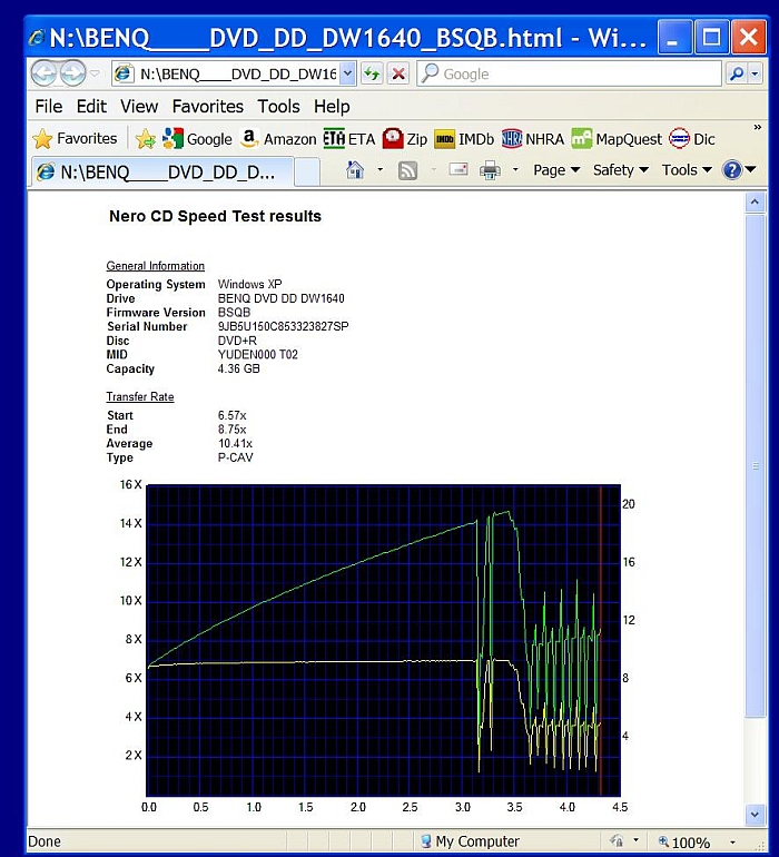

  5. here it is

    You cannot say that a disc has "rotted" or "gone bad" when it was never tested to begin with. The disc has more likely always been in this condition. Simply assuming a disc has changed over time is assumption, not scientific method.
    What's more likely to have changed are the laser conditions on your various players, burners and readers.
    This thread gives another good look at what PI/PO testing is limited. The TRT clearly shows errors while the other scan is supposedly clean.
    Lots of people also fail to properly remember where/when they watched a DVD. So many many copy or author discs, and never actually watch them for years. By that time, your memory has betrayed you, and you remember wrong. You may have watched the assets on the computer or while it was recording. Or you watched the original DVD. But you just forgot.
    Actual disc degradation is so rare that you should buy lottery tickets if your luck is that good.

  9. With a transfer rate scan like that you should immediately copy the disc onto a new one. Or rip the original again.

  17. I run a transfer rate scan on any important discs. If it's nice and smooth, or only a few little bumps, I call it done. With Verbatim Datalife Plus discs I rarely have a problem. Mabye one in a hundred burns.
