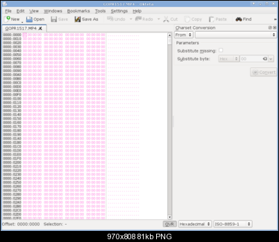

    Originally Posted by Akoen View Post
    Anyone who can help? I offer 40$ Here is a sample https://dl.dropbox.com/u/42976122/GOPR1517.MP4
    That file is just full of 0s.
    Nothing there to retrieve.

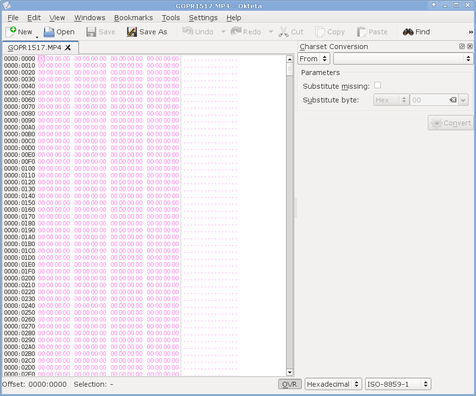

    Perl scrips and grauonline didn't work for me, i have tried.
    Is it possible to make a new header, and would that help? Could a recovery service help me?
    This is the contents of the file you uploaded:
    There's no video there.
    You need to go back to the camera or memory card and try extracting/retrieving the file again. Different recovery software might help. There's nothing that can be done with the file you uploaded.
  9. There's nothing in your file except zeros. It's like providing a VHS cassette with no tape inside and asking if the video can be recovered.
