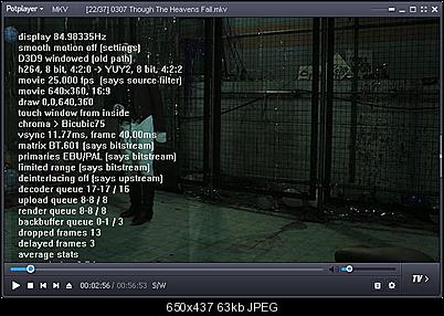

  1. I like potplayer but it started displaying file information on the left hand side that doesn't go away no matter what I press.

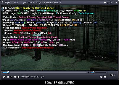

    Tab is for file information but this one is just there whether I press tab or not.
    Pressing tab displays file inormation in colorful texts. This is just plain white frame by frame information.
    What key enables/disables this?
    Thanks for suggestions.
    Screenshot is below:

    Did you solve this in the end? I have the exact same issue. I think I may have pressed a key sequence to activate this.
    I tried changing from madvr to another render & the screen info went away. So looked at my madvr setting but there is nothing in there to turn on or off

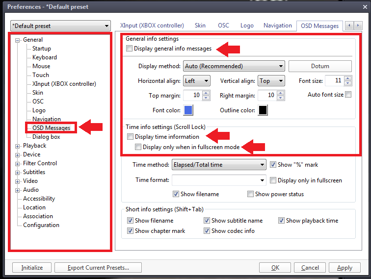

  8. This is dated back 4 years ago, but because no one seemed to freakin solve it here:
    1. right click (or F5)
    2. Look for preferences
    3 OSD info
    4. Everything on that first thing, "Time Method" and down, should be the only things checked.

  9. Originally Posted by Tarrabyte View Post
    3 OSD info
    If you are still getting info after that, then google the answer in a different way
    And 1 last note -
    I really hope you guys aren't actually using these forums any more cause theis place feels like it's been here since 2001.
    That's an interesting way to start out posting.... being completely wrong while trying to be clever about it. And then after claiming you have the solution, you say it mightn't be the solution after-all and to use Google instead. I've heard something about "first impressions".....
    Did you look at the screenshot in the first post? Is that what you see when the OSD is enabled? And what's the age of the forum got to do with anything?

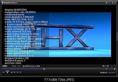

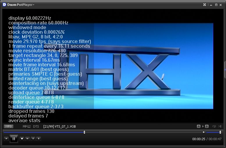

    Edit: It turns out maybe I was partly wrong (hence this edit to remove the evidence I originally said "the Tab key" has replaced Ctrl+J), although in my defence I rarely use Potplayer. My recollection is Ctrl+J was once the shortcut to "display statistics" regardless of the renderer. Obviously the screenshot in the opening post is displaying MadVR's OSD, which is MadVR-speak for "display statistics", and when the penny dropped I remembered MadVR still assigns CTRL+J to that function as does MPC-HC and MPC-BE, so Ctrl+J is the correct answer when using MadVR. I switched to MadVR and tested, and CTRL+J gave me display statistics instead of Potplayer wanting to wander off and connect to a webcam as it did when I was using another renderer. The Potplayer version of "display statistics" seems to be enabled via "the Tab key". Unless there's also a similar option I didn't see.
    To summarise.

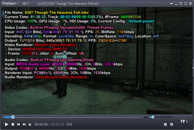

    The Tab key:

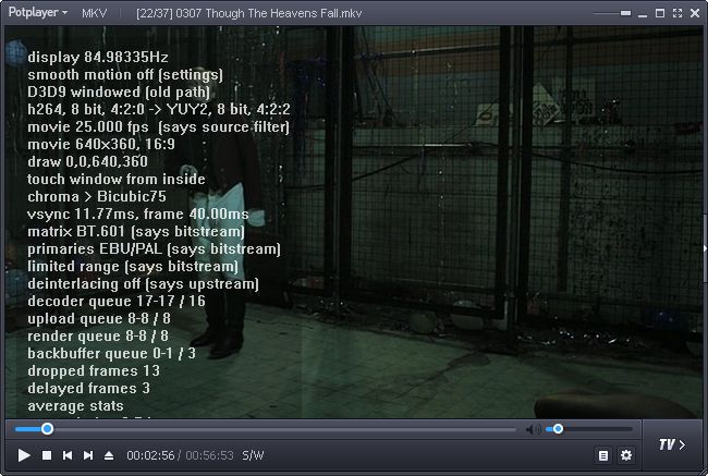

    Ctrl+J when using MadVR:

  12. Originally Posted by Tarrabyte View Post
    3 OSD info
    And 1 last note -
    [Attachment 36765 - Click to enlarge]
    Thank You ! I registered here just to say that, kinda stupid way it has been implemented in PP which is otherwise a great player
