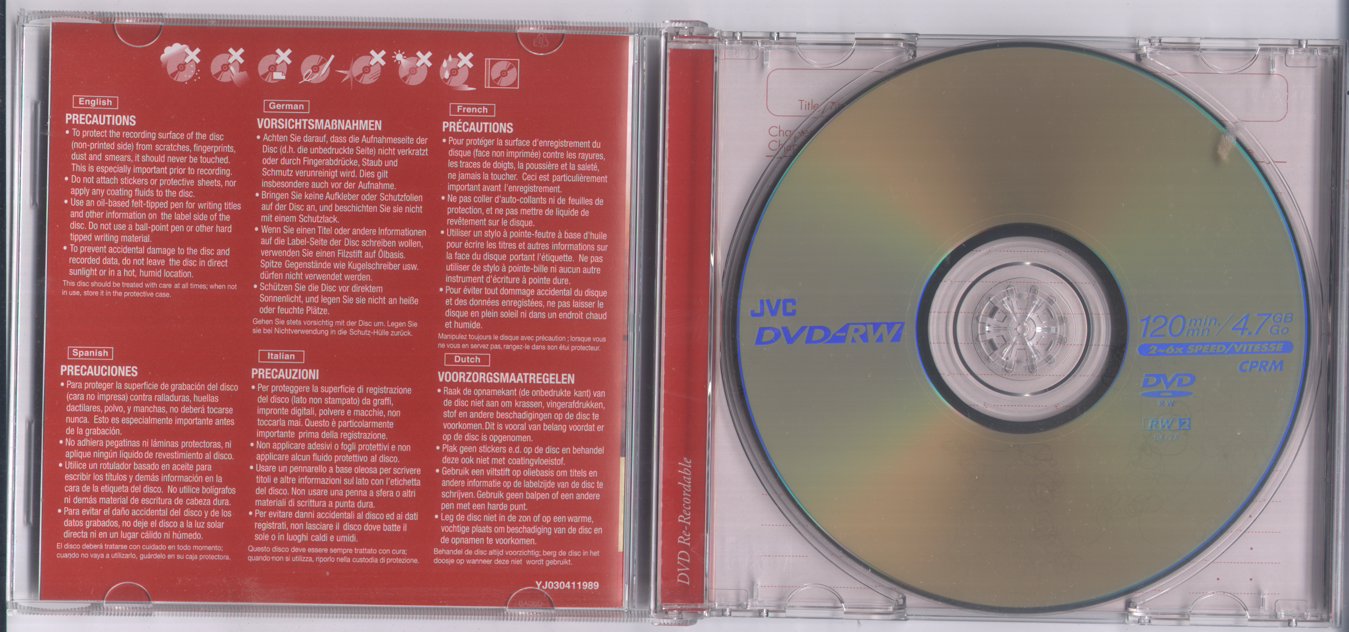

  1. I bought a Jvc dvd+rw in a local store today,when i come home,i searched the internet but i couldnt find any information about Jvc 's dvd+rw media,all about dvd-rw and victor stuff,my Dvd+rw 's media code is Prodisc w02,i looked but Jvc didnt produced any prodiscw02 coded dvd+rw or any dvd+rw,so my media is fake?
    Mar 2008
    On the left you'll see a column entitled "DVD media". Open it up and plug JVC into "search Media"
    You'll see that they use various manufacturers sold under their name.
  3. Hmm,the only jvc dvd+rw i found is RICOHJPNW11
    Seems like prodisc only manufactured dvd+r and dvd-r for jvc,so my media is fake ?
    Mar 2008
    Fake JVC media? I doubt it. Most likely you have something that's not in VH's data base.
    Judging by the info here, prodisc.w02 and ricohjpnw11 are similar in quality - listed in the 2nd tier.
    http://www.digitalfaq.com/reviews/dvd-media.htm

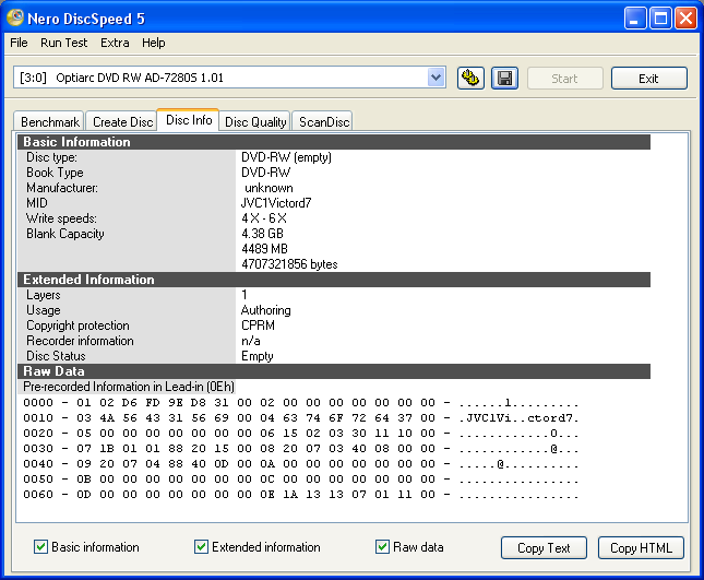

  12. I saw this post today, i have couple of jvc media RW silver brought by my cousin from USA 2-3 years ago. I was skeptic because i thought jvc didn't made any dvd media but dvd identifier says it is jvc and image burner the same it says on the dvd i tried to photo it but it is silver and when i point the camera at it shines like some sort of "water mark".
    What do you think LS are these dvd's good quality on left side is ver 1,2 /4x 4.7 gb Go, under that says 2-4x speed/vitesse?!
    http://victor-media.co.jp/media/visual/vd-w120xj5/index.html
  13. Video Restorer lordsmurf's Avatar
    What's the media ID according to ImgBurn?
    I've never liked DVD Identifier, because it's not showing you the raw ID data.
    It retrieves from an internal database.
    And I've found it to be wrong in a number of instances.

  15. Yeah I was wondering why none of the original posters in the thread said to see what the MID was in Imgburn or DVD Info ??
    How to find it i see information in read or verify but not "MID" information where it is located in imgb menu thanks
    HL-DT-ST DVDRAM GSA-4167B DL13 (ATA)
    Current Profile: DVD-RW
    Disc Information:
    Status: Complete
    State of Last Session: Complete
    Erasable: Yes
    Sessions: 1
    Sectors: 2.153.200
    Time: 478:31:25 (MM:SS:FF)
    MID: JVC0VictorD7
    Supported Write Speeds: 2x; 4x
    TOC Information:
    Session 1... (LBA: 0)
    -> Track 01 (Mode 1, LBA: 0 - 2153199)
    -> LeadOut (LBA: 2153200)
    Pre-recorded Information:
    Manufacturer ID: JVC0VictorD7
    Recording Management Area Information:
    MATSHITA DVD-RAM UJ-820S 575974 1
    Physical Format Information (Last Recorded):
    Book Type: DVD-RW
    Part Version: 3
    Disc Size: 120mm
    Maximum Read Rate: Not Specified
    Number of Layers: 1
    Track Path: Parallel Track Path (PTP)
    Linear Density: 0.267 um/bit
    Track Density: 0.74 um/track
    First Physical Sector of Data Area: 196.608
    Last Physical Sector of Data Area: 2.349.807
    Last Physical Sector in Layer 0: 0
    Format Capacities:
    DT: 0x02 - NB: 2153200 (0x0020DAF0) - TDP: 2048
    FT: 0x00 - NB: 2296256 (0x002309C0) - TDP: 2048
    FT: 0x10 - NB: 2296256 (0x002309C0) - TDP: 16
    FT: 0x15 - NB: 2296256 (0x002309C0) - TDP: 16
    Performance (Write Speed):
    Descriptor 1...
    -> B0: 0x02; B1: 0x00; B2: 0x00; B3: 0x00
    -> EL: 2153199 (0x0020DAEF)
    -> RS: 4.584 KB/s (3,3x) - WS: 2.770 KB/s (2x)
    Descriptor 2...
    -> RS: 4.584 KB/s (3,3x) - WS: 5.540 KB/s (4x)
    if i saw correctly MID also says JVC right?
    it seems that it is produced in Japan by JVC ( Victor company) according to some internet sites ( people get them as bundle with some pioneer dvd recorders in japan )
  16. Video Restorer lordsmurf's Avatar
    I'm going to assume that's an outsourced ID.
    Because I'm not aware of Victor ever having optical media production facilities.
    The real manufacturer could be anybody.
    It's also an old disc, from 2004 or before.
    There were a lot of now-failed attempts to compete back in 2003-2006.

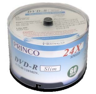

  23. Princo still produces media? Nobody that I've talked to in at least a year or two has been able to confirm it! Where are you, exactly?
    I am in Europe Balkan area. I don't know, LS what do you think it looks like this on the pictures could be fake and this site it is in USA http://www.qmediastore.com/dvdrlm47g24xpr/.
    In my country princo ( 8x and 16x media R-) it is very popular because of the price and the fact that it works on every dvd drive ( dvd recorders, re writers for pc and so on ) i used them sometimes and they really worked ok I even have some old ones that still work ok ( although prefer verbatim from the shop which is near my house and it is the main distributor for dvd and cd media in my country so i get it "cheap"). I asked them today and they sad that they don't have princo 24x yet imported (legally) but it could be some went trough some other channels had past in country and distributed them who knows.
    I think jman just came on a bit strong. It's his style. (And his facts were accurate, so he gets a pass. )
    i don't dispute that his and yours facts where ( and are ) accurate, he was wrong about the intention and the purpose of me using them, so the thing came out of context.
    Image Attached Images
  24. Video Restorer lordsmurf's Avatar
    That is a Princo style spindle.
    Hmmm....
    Interesting....
  25. Originally Posted by mammo1789 View Post
    Those Princo are very real, and just for fun, I picked up 120 of them a bit back. Cheap as dirt and I couldn't resist the challenge to burn a Princo at 24x
    They have the MID:PRINCORGM1
    I have not been able to find a single firmware that will natively burn these at 24x. I suspect the 24x on the label is Princo's attempt(albeit grandiose) to draw attention to the fact that these ultra-slim DVD-R are a new design and not at all the same as the 16x Princo discs sharing the same MID.
    You can literally roll these discs into a tube without breaking them. It's a shame they came on the scene at this late date. These are every promotional disc producers dream, could ship these in the cheapest of mailers or tuck them into a promotional flyer/magazine so easily.
    They are not a high quality disc by any means, but good enough to burn usable video discs in my testing. Set-tops read them fine(burned at a reasonable speed).
    I did manage to burn them at 24x in a Samsung SH-S243D after performing surgery on the firmware and swapping the Princo code for another.
    I'm guessing that it must be the unique polycarbonate formulation that Princo devised for these ultra-slim discs that leads to them being the most potently odorous discs I have ever run into. It is almost worth the $12.00 entry fee just to catch a whiff of that unique smell when you crack open the spindle
    If its OK to post this, more user feedback can be found here and here.
  26. Just to help answer the question regarding fake or real, here is the link to Princo's own page about these discs.
    And here is a link to Princo's own drive compatibility chart. Funny that they are so shameless about the "24x" name that they would supply a chart to prove that is is just so much fluff and nonsense. Maybe one of the drive manufacturers promised to update a firmware to allow 24x burning, then thought twice about it when they tried to actually achieve it

    I Just got 45 JVC 6x DVD-RW discs from ebay. They are made in Japan and the media code is JVC1Victord7. They are now available for sale on ebay http://www.ebay.com/itm/JVC-6x-DVD-RW-media-VD-W47GU5-4-7-GB-120-min-5-Pack-/181039805...item2a26d0356b
Name:	Optiarc_DVD_RW_AD-7280S_JVC 6x DVD-RW info.png
Name:	JVC 6x DVD-RW.jpg
Name:	JVC 6x DVD-RWinside.jpg
