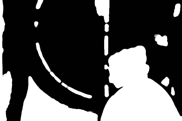

    Ok, I've been playing with flatmask. The clip that I'm working on is attached here, along with an image cap of my mask.
    My goal is to mask the lady, smooth the background and surrounding areas with TTempSmooth, and then smooth the lady with McTemporalDenoise.
    The mask was accomplished with this script:

  7. I think this is what you're trying to do:
    Mpeg2Source("sample1.demuxed.d2v")
    TFM(d2v="sample1.demuxed.d2v")
    TDecimate()
    mask=flatmask(last, str=100, luma=true, lth=40, upper=true, show=true) ###to mask the lady##
    tts=TTempSmooth(maxr=7,lthresh=30,cthresh=5, strength=5, interlaced=false)
    mt_merge(tts, last, mask)
    McTemporalDenoise(settings="high", sigma=4, twopass=true, useTTmpSm=true, chroma=true, protect=true, AA=true, edgeclean=true, stabilize=true, TTstr=8, enhance=true, AGstr=1.0, maxr=7)

    Thanks. Mask is set to true, but I can't see it.
  9. You're not supposed to see it. It's used to determine which parts of the image are taken from the two videos when merging.
    If you really want to see the mask add "return(mask)" right after creating it.

    Ah, I see. It worked. This is actually a great tool for what I need to accomplish, thanks alot Jag.
    Two quick questions, and then I'm on my way:
    1. I updated my script (below) and the results look the same as in your script...actually my background appears more stable with the script below. It does not have mt_merge like your script, only that line 4 in my script was changed to filtered(last). Is there a difference in the way this script functions when you don't use mt_merge? I ask because the mask is still protecting the parts of the clip that I don't want touched by TTEmpSmooth, but I want to make sure I'm not missing something.

  11. Yes, you can let flatmask to the merging for you. I'm not familiar with the maskpack.

  13. If you look at the last line of the flatmask() script you'll see that it either returns the mask or calls mt_merge() for you.
