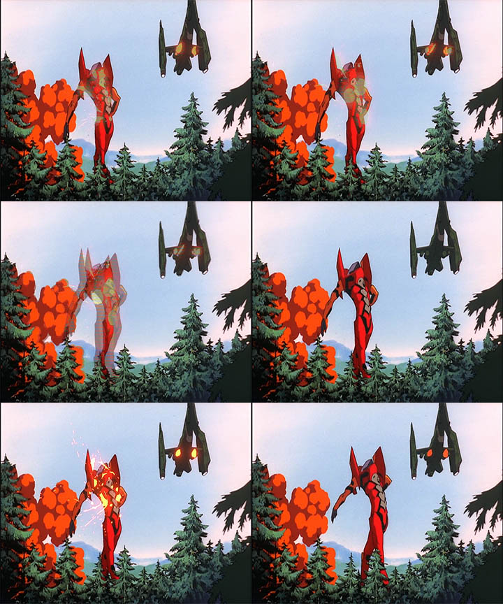

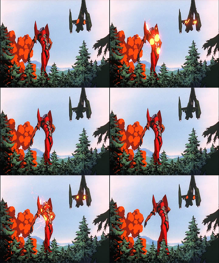

    So I took screenshots for your viewing pleasure^^ I don't really understand the interlacing scheme: These are 6 frames first set without Telecide, second with Telecide)
  9. I know it took you some time to create the pictures, but pics are pretty much useless. If you have questions about the source you should upload a short 10 second sample. Cut them using DGIndex and the [ and ] buttons to isolate a small piece. Then 'Save Project and Demux Video'. Upload the resulting M2V here or at Sendspace or MediaFire.

  11. That was interesting, thanks. There's all kinds of interlacing patterns in there, but the IVTCs straighten it out easily. You might add in 'Guide=2' to your Telecide line as it's used to help with the field matching of PAL progressive video.
