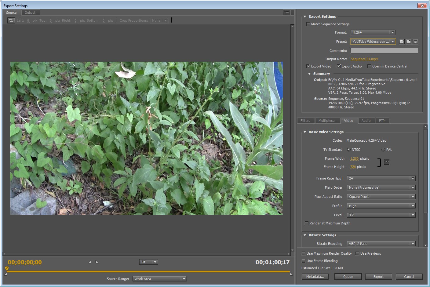

    The best I can do currently is upon export choosing the "H.264" "Format" and picking the "YouTube Widescreen HD" preset.
    The stats of that resulting file are as follows. You'll notice it is both larger in file size and smaller in resolution. (APPCS5.5 won't permit me to set it high enough.) This is insufficient.

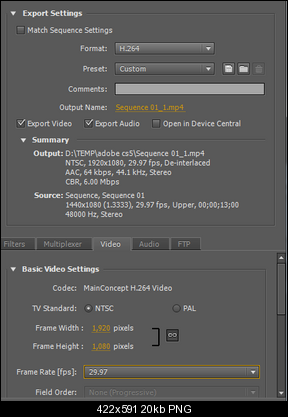

    if all you're looking for is 1080p30 h264 there are many encoding programs you could use. start with vidcoder, as it's an easy to use handbrake frontend and set you output to 1920x1080 @ an average bitrate of 6mbps. but premiere pro's encoder is quite capable of the same thing.

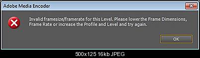

    When I try to force the file size to the appropriate resolution I get an error.
    "Invalid framesize/framerate for this Level. Please lower the Frame Dimensions, Frame Rate or increase the Profile and Level and try again."
