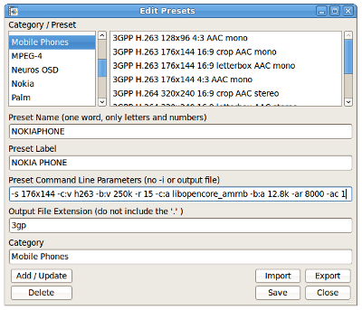

  11. Member bat999's Avatar
    Feb 2008
    Originally Posted by KathleenM View Post
    oh boy, i have to do some reading about ffmpeg first
    No need to struggle with FFmpeg...
    Consider using WinFF from here ---> http://winff.org/html_new/
    Make your own preset, look here ---> http://code.google.com/p/winff/wiki/HowToMakePresets
    (Or unzip the preset in the attachment and import it into WinFF)
    (WinFF > Edit > Presets > Import > Save)
    Preset Name:-
    NOKIAPHONE
    Preset Label:-
    NOKIA PHONE
    Preset Command:-
    -s 176x144 -c:v h263 -b:v 250k -r 15 -c:a libopencore_amrnb -b:a 12.8k -ar 8000 -ac 1
    Output File Extension:-
    3gp
    Category:-
    Mobile Phones
  12. yey! it worked fine now.
