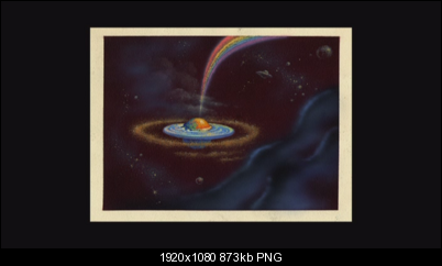

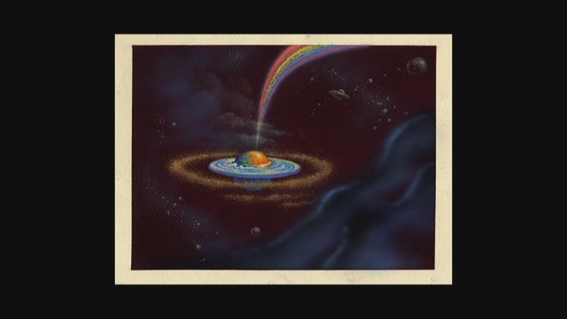

  1. Hi,
    I would like to change the duration of a DVD still image that is encoded as a .vob file, but i have no idea how to do it and with what program to do it.
    Any solution would be greatly appreciated.
    Thanks in advance
    P.S. If you are interested, I have attach the image I would like to edit as a full DVD.
    Oct 2005
    666th portal
    here it is as an image file. you'd need to find the original to re-encode to dvd again. it's already pretty low quality and encoding again will make it worse.
