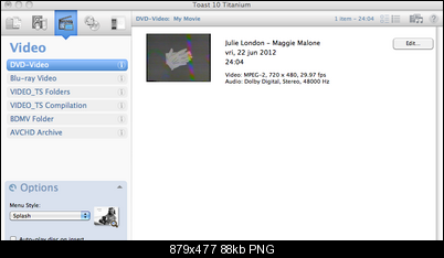

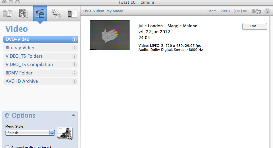

    I've burned it as vob, using Roxio Toast.Click image for larger version

  4. Originally Posted by HitTheRoad View Post
    So, you just burned the VOB as data, without authoring it as a DVD first? What did you expect?
    Apparently Toast can author it as a DVD properly. So do that. Maybe you'll have to demux it first. I have no idea, not ever having used that program.
  5. Step 1: Demux the VOB. Use DGIndex program. Once VOB is added in DGIndex, File->Save Project and Demux Video should give you an M2V of the video and whatever audio is in the VOBs.
    Step 2: 'Author' the DVD using the demuxed audio & video files as inputs. Use Simple DVD Creator'. It is free. This will produce proper Video_TS folder with .IFO, .BUP, .VOB files.
    Step 3: Burn the DVD with ImgBurn.
  6. Manono is sort of right, if you only got a VOB from your friend it's possible there may be some navigation info missing to properly playback the VOB in a set top player; you need the IFO too. Software players are able to get around that to maintain A/V synch. Next time get your friend to include all the files and preferably zip them into 1 file with no compression.
    Did you burn it using the DVD video option in Toast as in your picture? Have you clicked on edit and tried to play it to check if it skipped? Nharikrishna is on the right track, just the wrong type of computer. Try converting the VOB to DV with MPEG Streamclip, then import it into Toast; that might fix the timing problem.

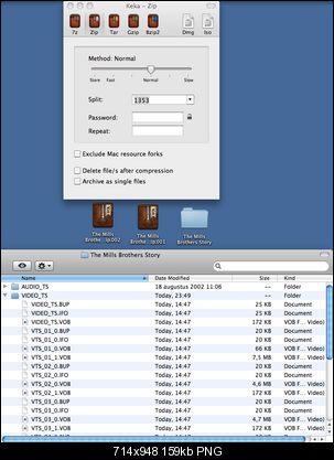

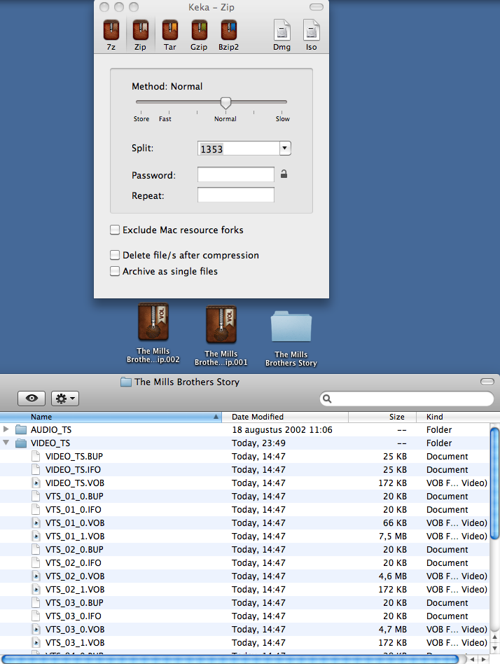

Name:	Screen shot 2012-06-29 at 23.54.54.png
ID:	12935Nic2k4, As you can see in the screenshot I managed to unzip and re-join all the parts of a VIDEO_TS without using The Unarchiver. This program is not installed on my Mac.
    You're telling me VOB's without the IFO's is not really the best thing to do. So you're advising me to use VOB2MPG or MpegStreamclip to convert VOB's to MPEG2.
    I've always done it that way with my own DVD's:I feed the VTS.VOB's to MpegStreamclip and then convert them to MPEG2. I've also done this with the VOB's my friend sent me. But this didn't help to get the audio and video in synch again.
    So I'm still confused about how this can be explained. As far as I can see (after reading all remarks) my friend nor I are doing anything wrong. First he rips his DVD completely to VIDEO_TS. In case he wants to send me only a chapter of the video he simply drags the corresponding VTS.VOB's from the VIDEO_TS.
    He sends the VTS.VOB's to me using WeTransfer. WeTransfer automatically wraps the VOB('s) into zip-files. After I have received them, I unzip the wrapped VOB('s), merge them (using MPEG Streamclip) and convert them to MPEG2 (using MPEG Streamclip).
    I can now play the file in VLC or burn it to an authored DVD (using Roxio Toast).
    Please tell me if I'm forgetting something.
