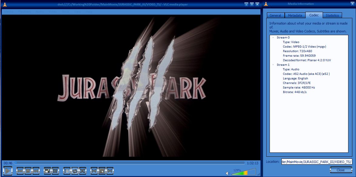

    Jurassic Park III Widescreen Edition DVD which I own plays at 59.97 fps. Have a few others that do as well, but don't remember offhand which they are.
  13. Originally Posted by Jason149 View Post
    Stop making these idiotic claims. There's not a DVD ever released that outputs 59.94 frames per second. Sure, it can output 59.94 fields per second, which are bobbed into frames, but that's not the same thing as what you're saying.
    Since you're unwilling to upload any samples for us to have a look and then explain to you what's really going on, I'll just leave it at that.
  14. Originally Posted by manono View Post
    Are you blind man?! It's not an idiot claim. its fact just look at the screenshot. I don't care what it outputs at or what you're comparing it to. Its a dvd made at 59 fps....period. Sure I could upload loads of samples if you wish, but I dont care to know whats going on, just proof that its a dvd running at 59 fps. Thats all that needs to be known. I could upload tons of proof and you'de still have something to complain or argue about. Just trying to clarify the above post and I think I've done that.

    It's FIELDS per second.
  16. Banned
    Freedonia
    It's unfortunately becoming more and more common for software programs to confuse fields and frames per seconds and report the former as the latter. This is what is going on with your DVD. This is just leading to a lot of general confusion. I had a discussion here some months ago about this very thing as it seems that VLC sometimes does this too depending on the source. But 59.97 fps DVD is not supported. A tool like the free version of the Tecoltd Bitrate Viewer (get it under our Tools section) can be used to open one of your VOBs and it will tell you the true fields per second if you still have doubts. Note that you may need to rip the DVD to your hard drive first. I don't claim to be an expert on frame rates but I don't think old standard definition tube TVs were capable of displaying video at 59.97 fps anyway and DVDs were designed for standard definition TVs.
  17. Originally Posted by Jason149 View Post
    Where did I say I was unwilling to upload any samples?
    My mistake and I apologize. I mistook you for someone else who claimed that uploading samples was forbidden.
    And as jman98 says, this is something peculiar to VLC player. Check a VOB in the Tecolt BitrateViewer, in ReStream, GSpot (which is particularly good at this), MediaInfo, or a host of other apps and you'll quickly see the error of your ways. Your DVD is no different from any other in that it outputs interlaced 29.97 frames per second. What VLC player may do with that is something else entirely.

  18. Originally Posted by Jason149 View Post
    VLC is telling you what frame rate it is playing the video at, not what the frame rate of the source is. The source is 29.97 frames per second with two fields per frame, 59.94 fields per second. Progressive computer monitors can't display interlaced video. So VLC is converting each field to a frame. So the 59.94 fields per second of the DVD is being converted to 59.94 frames per second by VLC.
  19. @Hech54 @jagabo Thanks for info. Was never aware of fields per second and did seem odd that a normal dvd would be running at that high a frame rate. I did throw the dvd into mediainfo and showed 29 fps. Thanks for clearing that up.
