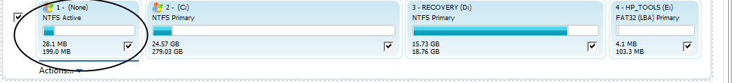

    I've been toying with the idea of adding an SSD to this laptop and wanted to clone the existing drive to the SSD. I installed the free version of Macrium Reflect and I noticed a partition I've never seen before. Can anyone tell me what this is? Is it a boot partition? If so, will I have to clone that to the SSD also?

    Most likely the hidden partition is where your laptop manufacturer put the windows restore/recovery files so its best to include that in your cloning.

    depending on the laptop maker/model it is most likely the restore partition. most of them have windows install files built in so a format/windows install to original files can be done.

    The small partition (200MB?) you have circled looks to be a Windows partition that is part of the OS. Common on PCs. The recovery partition is likely the larger one. (18GB) If you plan to clone the existing boot drive, best to clone it all. You could probably eliminate the recovery partition, but then if your HDD/SSD dies, no recovery, sometimes not even if you have the recovery discs. (Depends on the laptop manufacturer)

    Yes, that's the boot partition (which the infinite wisdom of Microsoft calls "system partition"). You can make it visible to Windows Explorer by using the appropriate "Administrative Tool"/whatever in the Control Panel. Also, it's the ACTUAL "C:" partition , but as we all know, Windows needs to fool itself and make believe the D: partition is the C: one

    Just viewed the picture,i cloned my hdd and didn't include the hidden boot partition when i restored the drive,learned my lesson that time,no boot.

    The D: and E: drives are the restore and HP tools partition (Diagnostic Tools) so that hidden one isn't either of those.

    So it looks like that hidden little partition is the boot drive. So if I were to "clone" the drive with Macrium...make sure I include that unnamed/hidden drive?

    That partition is created by windows 7 to store files during the install process.
    Drive management dose not generate such a partition.
    To clone with macurium, backup each partition the restore from first to last ... macurium dose not support restore of more than one partition at a time.

    The partition circled (labeled "1") is the drive's boot partition. "C" is your Windows partition. "D" is your system recovery software. "E" is a utility partition, probably designed so that utilities can be run without starting windows. Many hardware utils won't work if the OS is running, or many work with Windows "on" but run only outside Windows in a separate window.
