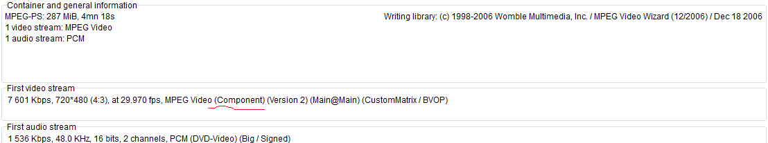

  1. hello i found MPEG 2 video file.and it's in NTSC specification.but media info shows its video standard as "Component".what is that ? and how can i change that to NTSC without loosing video quality ?

  3. I actually tried to figure out what it meant and thought it meant it was an MPG at first, rather than authored for DVD. But I was wrong. Any M2V I mux as an MPG also shows as NTSC, My suggestion is to author it for DVD (Muxman), perhaps after demuxing it, followed by demuxing it again (PGCDemux) and I would guess the M2V will show as NTSC then.
    Why is it so important to you that it show as NTSC in MediaInfo anyway? Maybe that's what Womble writes into the header after it gets finished. But I don't have Womble and can't test. Maybe someone else can.

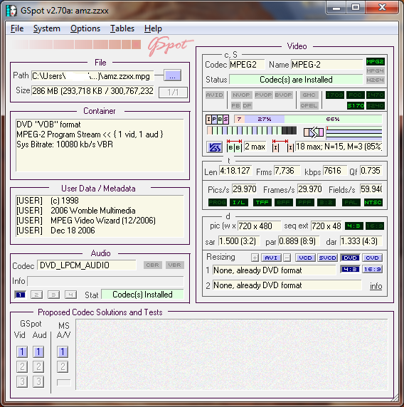

  10. a screenshot of the gspot results might help as well

  12. mediainfo details

    gspot details

  13. Member DB83's Avatar
    Jul 2007
    Well that 'C' word is there. And no reference to it in the specs for mediainfo - that just says NTSC or PAL.
    Blonde moment time. Is it possible for a video camera to shoot digital component video as 720*480 29.97fps. Write that 'C' word in to the file-header etc.etc.
    I was thinking that even some UK cameras shoot at 'NTSC' spec.
    Just a thought. Do not shoot the pianist.

    That does not add up. A dvd can either be PAL or NTSC. My friend,above, determined that Womble in the ordinary sense does not write 'Component'
    I will throw another theory in to the hat then. Someone, I assume this is not you, had a dvd and recaptured that in to a PC using Component Cables.
    So maybe, just maybe, the capture hardware/software left its mark on the video which was picked up by Womble.
    The bottom line, as has been said several times, you have an NTSC video. It is dvd compliant. Maybe I missed this but does it play without any issue ?. If it does then its akin to using a sledge-hammer to crack a nut if you just want to re-encode that - and lose quality - merely to see the word 'NTSC' instead of 'Component'
