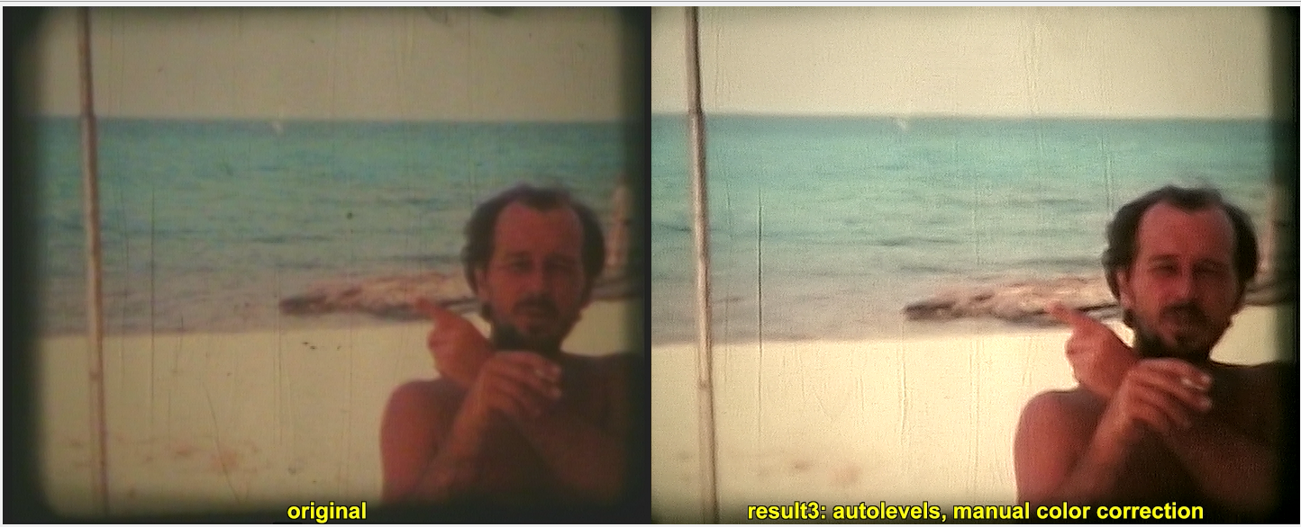

    Today i borrowed another camera dv cannon d110 35x zoom 720x576 bought cassette and firewire cable but it seems that my pc windows 7 64x cannot recognize the camera can it be that the port is burnt or my port on the pc is burnt.
    Anyway i captured trough video out analog to vdub 720x576i then tomsmocomp smart bobed and used fred script I think it is better on the color clips then with my old camera and in pair with hd mp4 camera ( and that is without using the digital connection ) but still something is missing like the cameras cant be as sharp as the projected picture i don't know why
