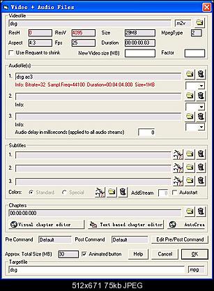

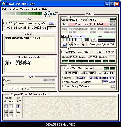

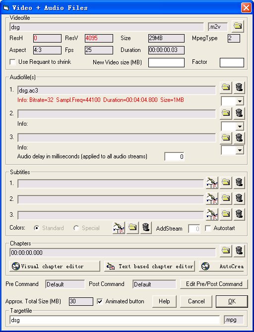

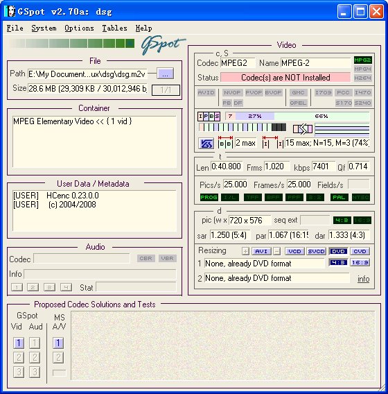

  1. Just used the latest DVD Slideshow GUI to export a video to GUI for DVDAuthor and found the subject error (ResH=0 and Duration=0.03s). Please see the screendumps from GFD and GSpot for more details. i've reinstalled both GFD and DSG several times but the problem persisted. I'm using XP sp3. Could you advise me how to rectify the problem?
    In addition, when I tried to run GFD on Vista, GFD hang when I tried to add video. Can GFD run on Vista?
    Your help is much appreciated. Thanks a lot!

  2. Your thread title says there are problems with both the resolution and the length.
    Have you played the results? Is something wrong? GSpot shows it to be 720x576, 4:3, and 40 seconds long. Is that not correct? Doesn't it play with 'normal' aspect ratio? Is it not 40 seconds long?
  3. Thanks for your reply.
    The info shown on GSpot should be correct, it's PAL 720*576 and 40s long. Though the video could be added but couldn't be played. In the preview, the duration is ??? and the screen is black. I tried to burn the DVD but Muxman said there was no video and the process failed.
  4. Furthermore, the m2v can be played with VLC normally. And I tried to add m2v of other size and length. The resolution and duration were also wrong (same as those shown on the dumps, 0.03s and 0*4095).

    But the audio spec is red, indicating a problem, because it used a 44100 sampling rate. DVD audio must be 48000.
    Remake the audio correctly and it should work.

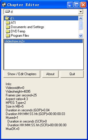

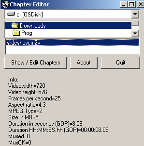

    One more thing to test... You can run the chaptereditor ChapEditGFD.exe and open the file there. It uses the same functions to read the m2v file (which is a direct low level binary file inspection - no dll or registry or 3'rd party software is involved).

  20. The problem persisted after reinstallation...Please find below the attached dump of Chapter Editor.Furthermore, when I tried to edit (moved the slidebar) the m2v on the pop-up window, "Run-time error 6: Overflow" occurred.

  22. I'm really sorry, but I have no idea how to solve this problem. As I cannot reproduce it on any of my computers (I tried your file on 4 different computers running XP or Win7 32 and 64bit without any problems), the only way would be to sit in front of your computer with a visual basic debugger...
