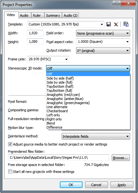

    ok... which 3d mode will produce bd3d?

    if i'm shooting with 2 canon dlsrs 1920x1080 would i use side by side full or half for bd3d iso output?
  15. aBigMeanie aedipuss's Avatar
    Oct 2005
    666th portal
    the bd3d output help blurb is only in the sbs half section, does that answer my question?
