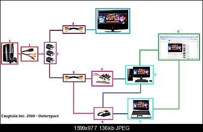

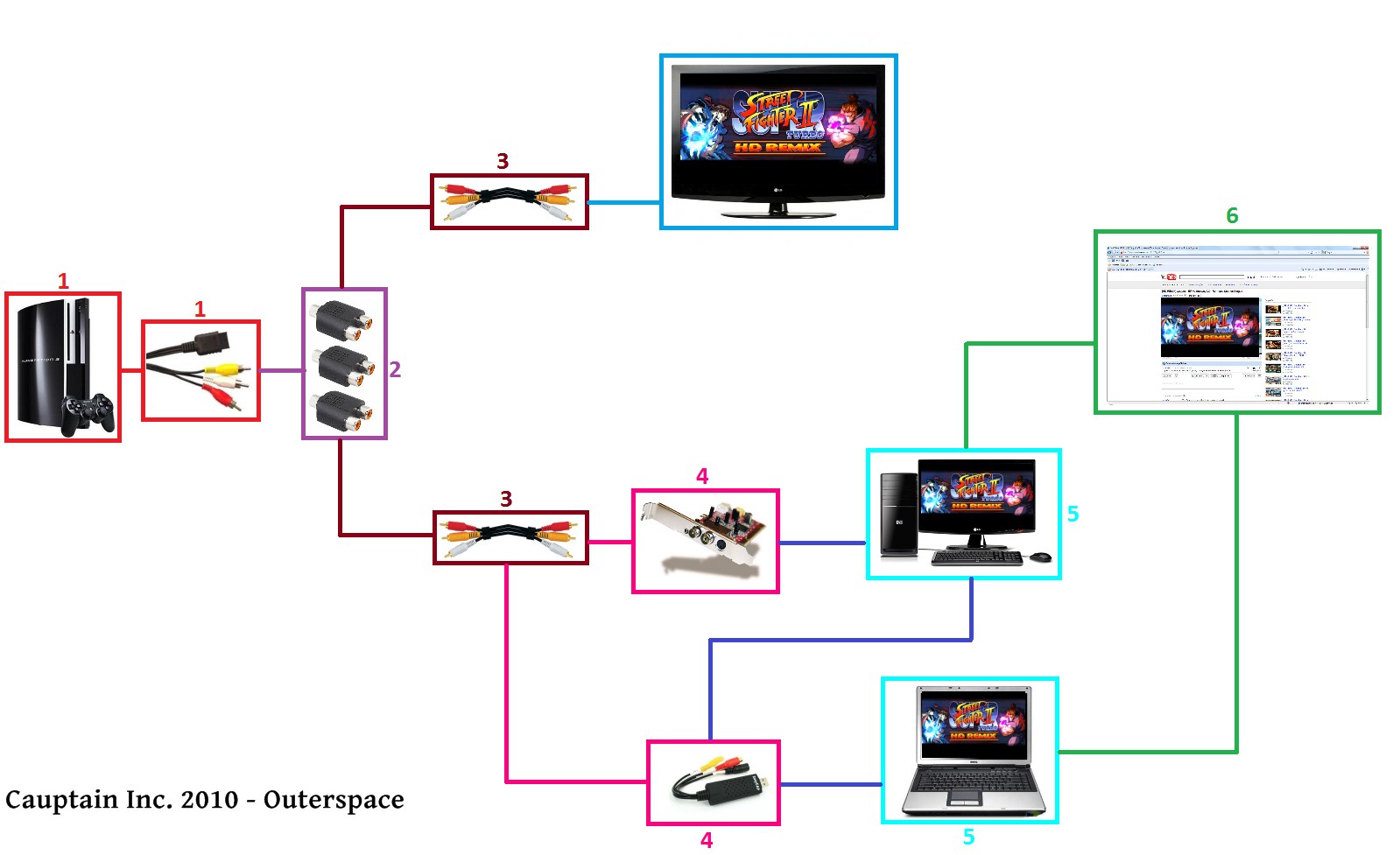

    Schema using RCA splitter and any analog capture card.
    Any doubt, reply.
