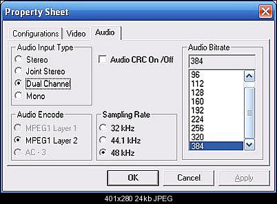

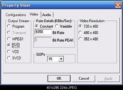

    I have a Hauppauge PVR-150 capture card, and I'm using WinTV v.6 to capture.
    My VHS-C camcorder only has a yellow and white cable outputs... no red. I guess this means the camcorder records in mono? It sounds like it does too.
    When trying to capture video, I had to set the audio setting to "dual channel". That way the recorded video plays back from both speakers. If I leave the setting on "joint stereo" or "stereo" or "mono", the audio only plays back from the left speaker.I set the video capture output stream to "DVD" at 9350kbps constant, and the audio to MPEG1 Layer 2 at 48kHz and 384kbps (there is no way to change the audio to AC3 or MPEG Layer 1 in WinTV). I want to get the best possible video quality, but I dunno about what setting to put for sound... is the one I have too high? That is my first question.
    My second question is: If I wanted to burn my captured video to DVD in the future, what audio settings should I pick?
    I placed one of my captured videos into AVStoDVD, and the option to use DVD compliant video was checked, but the option to use DVD compliant audio was not checked, and it was uncheckable. I'd rather not have to convert my audio and lose quality, so this is why I'm asking about what audio settings I should use if I wanted to burn the captures straight to DVD.
    Third question: are there any programs that would allow me to cut clips out of my captured videos? All I need is to cut clips out and make separate files. Stitching clips together would be great too if it's available. I'd like to do this if I was to upload my captures to YouTube. (I tried using VirtualDub to try to cut clips out, but it just popped up an error when I tried opening my captured file).
    Here are my video and audio settings windows of WinTV:

  2. Member Cornucopia's Avatar
    For your existing VHS-C footage, get a VHS-C adapter to use in a regular VHS deck. For New/upcoming footage - get a newer camcorder.
    If you have 2 channels of audio, setting it to 384kbps is probably decent enough (you're still losing a tiny bit, but it may not be noticeable to you). For TRUE DVD compliance though, you want to convert your MP2 audio to AC3. Use aften or similar encoder from this site. Oh, and the bit about Dual channel vs. others shouldn't really be affecting your speaker outputs, but just so you'll feel better, leaving it as D.C. at that bitrate in MP2 shouldn't do any harm.
    re: best possible video quality,
    MPEG2 at DVD rates isn't the best for capturing. If your ultimate goal is DVD-Video compliant discs to watch, it's not a bad compromise, but those on this site who are picky about their VHS capture usually cap as Un-/Losslessly- compressed (usually in AVI container).
    If you are capping to MPEG2, what you DON'T want to do is go back to uncompressed and recompress it to MPEG2 for a DVD. That's what you're doing with AVS2DVD. All you need to do is convert the MP2 audio to AC3 (like I suggested above), and then author your M2V and AC3 into VOBs and burn. Plus, I'm not surprised AVS2DVD won't let you uncheck that: MP2 is NOT compliant for DVD-Video in NTSClands, so you'd HAVE to reconvert it.

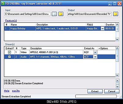

    I got eac3to, opened up the stream extractor, and picked M2V for video stream, and AC3 for audio stream. Did I do this right? Now I can use AVStoDVD to combine those files?

  6. Member yoda313's Avatar
    Jun 2004
    The Animus
    Yes you can use that with avstodvd.
