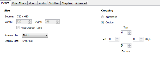

  5. Handbrake can crop the picture to remove the scan lines, on the Picture tab select custom and add a few lines on the top and bottom. As for format, MP4 is widely supported so I would output to that.
    would just like to say a big thanks for this, having spoken to the guy he said he accept getting the files back as MKV and MP4 providing the white linesat the had been cropped and they are extremely good quality. I did his grand daughters christening video. as MKV a 1 hour 30 mins video was 1.3gb size and seemed excellent with no white lines. I would have liked to have got the video down to around 800mb but couldn't see how else to make it smaller (unless i cut ratio) or see a preview of the size of what the file would be
    I didn't realise that the main place he'll be playing these video's is on his ipad, why he suggested Xvid i don't know but having spoke to him he said all his present files are in that format and wanted them all the same.......he was ok with both formats, so thank you very very much for your help.
