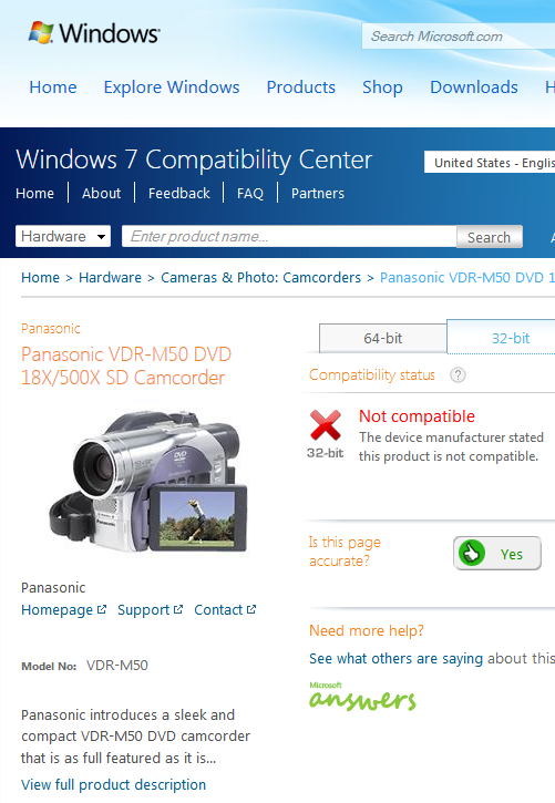

    that's all i could find, and it turns out the driver was never made for vista or win7.

    Thanks for the info - it never occurred to me to look in the Windows compatibility area. My son uses xp and I use Win7. I'll have to think about buying a camcorder of my own, main purpose will be to record music at jazz gigs. I can't afford much - up to say £100, anyone any suggestions? I'll also post seperately as a new topic.
