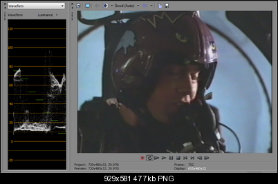

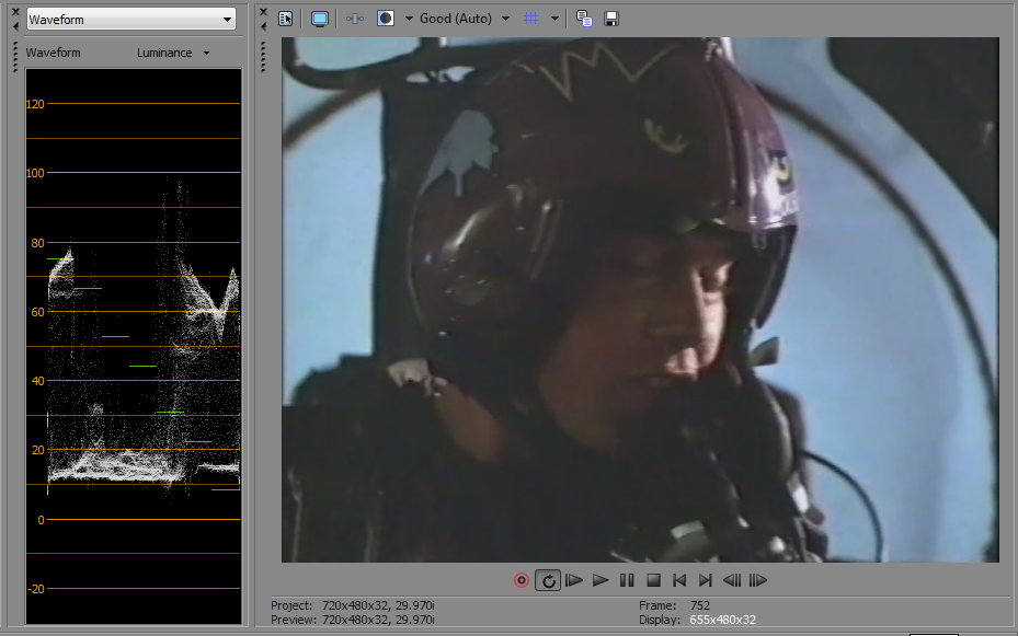

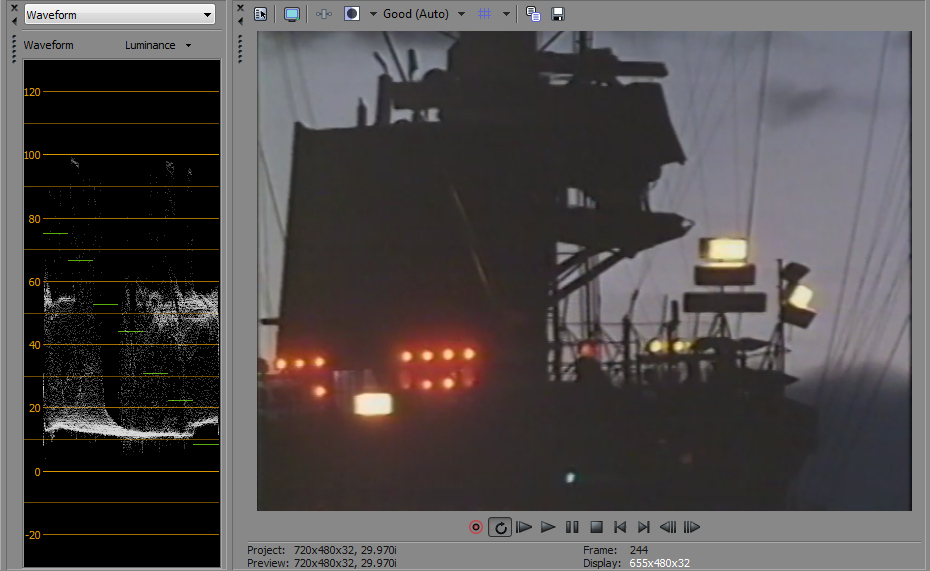

    The Top gun clip appears to be deinterlaced, not inverse telecined so exhibits jerky progressive playback.Also capture black level is way off.
    There is no real point to capturing a low res version of a film thet is available in DVD and Blu-ray.

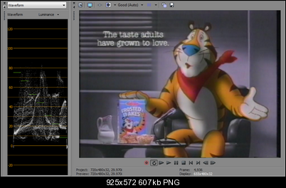

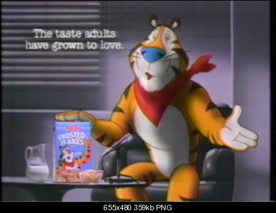

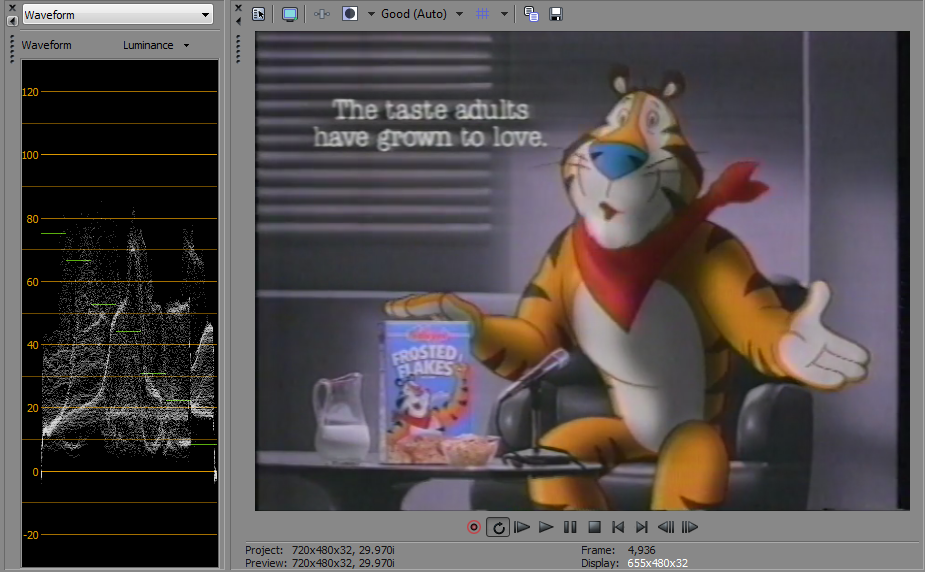

    The commercials are more interesting time capsules. Again the capture levels are off and the video has been deinterlaced. I'd capture these interlace MPeg2. The DV capture would have been interlace lower field first.
    Black is at 0 IRE instead of 7.5 IRE*. White level is low by about 20%. The left H shift is probably a capture device issue**.
    Corrected luma levels.

    Both of these were captured in DV format through the A/D converter built in to my Sony DCR-TRV730 Digital8 camcorder
    Many Sony DV camcorders cap black to 0 IRE (Japan NTSC) instead of 7.5 IRE (N American NTSC). This needs correction in post.
    ** The DV camcorder is capping 720 pixels wide while 4:3 analog works out to ~704. This explains the right side black stripe.

    The prerecorded movie has white levels typical for movies (a bit low on white). The black upshift was dure to the DV camcorder issue. Both can be corrected.
    The commercial clip appears to have been recorded with ~20% low gain. This was either a VCR calibration issue or a gain issue with the TV composite out. This too can be fixed but at a signal to noise cost as white level is raised.
    Measurements and corrections should be done in the DV format before encoding. As said above, I'd go for interlace lower field first MPeg2 DVD encoding after correction..

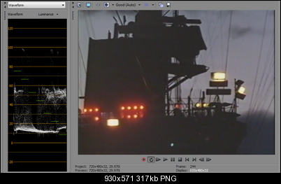

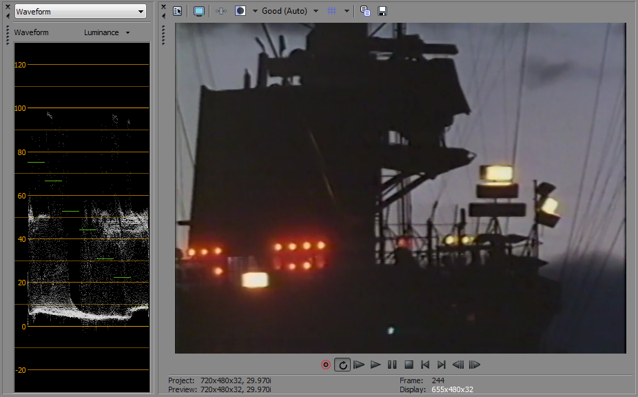

    I found a clip on your Top Gun file where peak white was higher. It appears the low whites were intentional. The high blacks still need to be fixed.

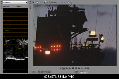

    Fixed
    PS: The above shows that the player is outputting correct levels. The Sony DV camcorder is recording 7.5 IRE to digital 32 instead of 16 so needs correction. The commercials were recorded at ~20% low gain levels.
