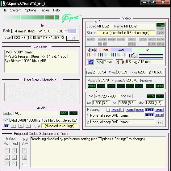

    Hi. I have this movie that a friend recorded from TV (.IFO/VOB format) The playback is jerky, there are
    duplicate frames in the following exact pattern:
    123455 123455 123455
    FRAMES TIME
    VTS_01_1.VOB 38928 (21:38)
    VTS_01_2.VOB 38941 (21:39)
    VTS_01_3.VOB 39331 (21:52)
    VTS_01_4.VOB 38528 (21:25)
    VTS_01_5.VOB 8215 (4:34)
    TOTAL FRAMES: 5468
    TOTAL TIME..: 01:31:08
    RUNNING FPS.: 29.970
    How can I delete the duplicate frames, while keeping audio in sync and FPS DVD compliant?
    Thanks in advance.
  2. What is odd is that gspot says its 30p - that's is atypical for a TV recording (perhaps it was deinterlaced somewhere and not Inverse Telecined like it should have been? )
    You can probably do it with avisynth, TDecimate() . This will return 23.976 fps progressive (original film rate) . This is DVD compliant if pulldown flags are added. You cannot remove duplicates without re-encoding
    If you post a small sample with motion, like a panning sequence (e.g. cut with mpg2cut2), someone will confirm and suggest what needs to be done
  3. That's PAL 25 fps to 29.97 fps NTSC with frame duplicates. Use TDecimate(mode=2, rate=25) in AviSynth. You could use SelectEvery(6,0,1,2,3,4) but you'll find that the pattern changes every 30 seconds or so because of the difference between 29.97 fps and 30 fps.
  4. Originally Posted by jagabo View Post
    Ahh you 're right ... he said: A,B,C,D,E,E ; not A,B,C,D,D . My bad
    But 720x480 25 FPS won't be compliant on NTSC DVD players
  5. Originally Posted by poisondeathray View Post
    Yes it is. Encode 25 fps progressive, then use DgPulldown to apply 3:2:3:2:2 pulldown flags. The resulting video will have judder similar to regular 3:2 pulldown, but not the 5 jerks per second of frame duplicates.
    Right, that will work
    I should have remembered, I 've done that on PAL content before . And I think we were discussing something similiar just a few days ago LOL
    Sorry, can you explain how can I do that?
  8. Encode as 720x480 25 fps progressive with whatever MPEG 2 encoder you want. Then open the resulting M2V file in DgPulldown and use the 25 -> 29.97 fps function to create a new M2V file. Use the new M2V and the original audio to make an NTSC DVD.
