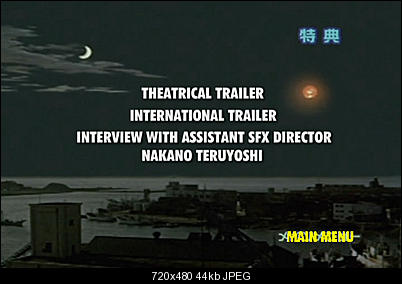

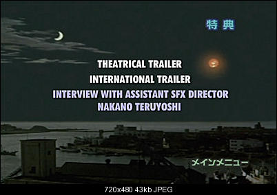

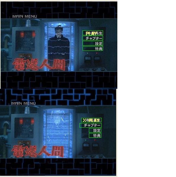

    sorry for any confusion. I wasnt suggesting editing or animating the menu I was describing. That (static) menu was suggesting a solution to adding translation to foreign text motion menus without all the video re-encoding, etc, as described in manono's guide (which I've consulted on many occasions - as Capt. Kirk would say, "it was required reading at the Academy"). I was mainly asking if it would work on motion menus as it apparently did on the static menu.
    I have a Japanese-text motion menu which I will experiment with, see if changing the subpic works as below.
    Meanwhile here's 2 pics of the menu I first described. Ignore for the moment that someone probably did photoshop the background and added English buttons. When I navigate down from the highlighted "Interview" button, the English subpic appears over the Japanese button. It might not seem pretty, but I think it's acceptable.

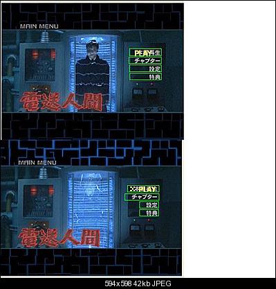

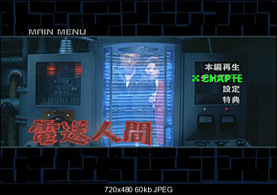

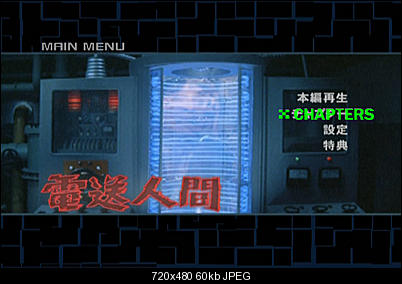

    Using Dvdsubedit and photoshop, I tested the first motion menu screen, seems to work fine so I'm hopeful about the rest of the menus. My added text was bigger than the highlighted area, so I expanded the highlight area using Pgcedit. As it turns out, this specific menu has 2 sets of buttons and Pgcedit warns it doesnt support more than 1 set. In other words, I couldnt expand the highlight area for both "plays" of the menu, so text is visible (or cut-off) every other cycle (see pics). Obviously I'll just make my text smaller to fit in with the original menu highlight area, though it would be nice if Pgcedit had worked.
    Actually I really do need to access those other buttons because my text would have to be too small to fit in the highlight area, but that's a pgcedit question.
    Otherwise, damn simple solution for translating menu buttons (in static or motion menus).

  6. Indeed, PgcEdit is not able to change the content of the second set.
    Most of the time, the multiple sets of buttons are not real sets: they have exactly the same parameters than the first set, and therefore can be ignored. Unfortunately, even if all parameters are identical in all sets, it might still be useful to define several sets, for example to animate a button highlight. (The fact that several sets exist forces the player to reload the subpic stream at each set, and if it has changed, a sort of simple animation of the highlight can be shown.) It's why PgcEdit cannot assume that the following sets can safely be merged with the first set, even if all parameters retrieved by PgcEdit are identical.
    Luckily, in your case, there are only two sets, so we can assume safely that the multiple sets are not used to animate the highlight. But it can be used, for example, to display an additional button leading to an hidden bonus, or to change the position, the colour, the size or even the command of a button. We need to verify that.
    Use the Info -> Multiple Sets of Buttons/BOVs function of PgcEdit to display the information about the sets. Here is an example of its output:

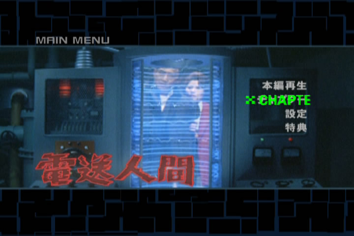

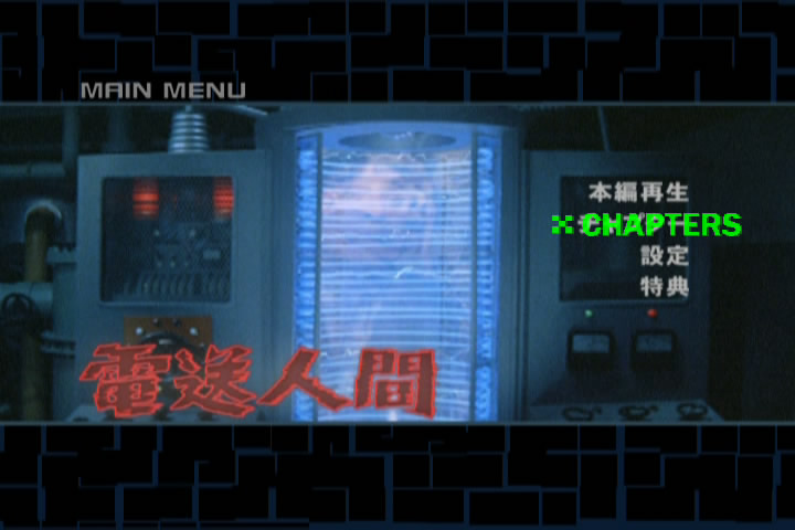

    thanks! That got rid of the Pgcedit warnings, but I still see the two motion menus playing. The only edit I initially made in Pgcedit was changing the button highlight areas. I tweaked them slightly again and saved, but didnt make a difference (still two sets as shown while playing).
    You can see (images from Dvdsubedit) the two button fields. In case you notice, I changed the subpic color from green to yellow, but it's not relevant to the problem.
    Perhaps I cemented the problem at the beginning, when I replaced the subpics for both button sets in Dvdsubedit. Should I start with a fresh copy of the movie, fix the Highlight Status, then run it thru Dvdsubedit?

  8. Originally Posted by spiritgumm View Post
    Hum, perhaps. But first, try to force PgcEdit to reload the buttons from the VOBs (with File -> Find Menu Buttons). And then, again, change something in the menu editor, and save. Verify.
    In DVDSubEdit, you might have to replace the subpic image at the two places. Does it show you several subpics (probably identical) for the same cell?
    Note also that, in many DVDs, the menu is authored in two different PGCs: the first one is called when the DVD is inserted, and shows a menu intro and then the menu buttons once, and the second one is the looping part of the menu, also with the menu buttons. If it's the case of your DVD, you have to process the two PGCs with PgcEdit and DVDSubEdit.
    Also, for a 16:9 menu, don't forget that you have to replace the subpic for the 2 (or, rarely, the 3) display modes. But that's another point. (And, although the main part of your menu seems to be in 16:9, there are horizontal borders with video content, so I guess it's a 4:3 menu, with only one display mode.)

  9. Member spiritgumm's Avatar
    Jan 2004
    inre the replacing subpics for both button sets, that's what I did originally. That's what I thought might have "cemented" the problem of showing two sets.
    There is just the one PGC for this menu, and no "<" (arrow) above the Menu Buttons window to access a 2nd set.
    I reloaded the dvd, changed highlight status, replaced subpics, tweaked the button location fields, but the location fields for the 2nd set show up as original (same as above picture). In case I didnt articulate correctly, it's the button location fields I'm trying to change to accommodate the new subpic text.
    Mediainfo indicates the VOB is 32 seconds, but Pgcedit and Vobblanker show it as 64 seconds. The actual video content shows a 30 second clip which is repeated. That got me thinking - regardless of the real runtime, if I edit out the 2nd half of the VOB in Vobblanker (or edit and reinsert with Pgcedit), maybe the 2nd set of buttons wouldnt be called. Using Vobblanker, that seems to have worked. Havent played it on a dvd player yet.
