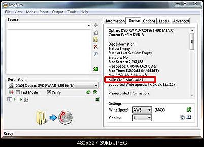

    What media did you use for the 'problem' discs? You didn't use DVD-RWs, did you?
    If you're in doubt (if you're using cheap/bargain discs, for example), you can use Imgburn to get the Media ID for the discs. With one of the blanks in the writer, open Imgburn. Select 'Build' from the Mode menu, and click on the 'Device' tab in the window. Imgburn will list information about the disc, including its Media ID.

    Are the rejected discs still readable in a computer? If not, you can try ISOBuster (shareware) or ISOPuzzle to try to retrieve the contents of the DVDs.
