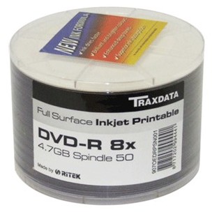

    i have used both Taiyo Yuden(top discs But High Price) &
    Verbatim. great results but for a cheaper disc i found Traxdata Ritek 8x Full Face Printable DVD-R (50 wrap)
    at around £16 For 100 G05 dye
    & had good results with long lasting media & print quality, i used them on epson & canon but not on brother. if i need to do family weddings & the like i tend to use the taiyo but thats just my preference.
    will have to look into the brother printer as the inks cheap too.
