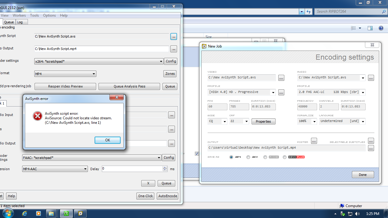

    Forget MEGUI. Its the problem.
    Get RIPBOT264, will work.

  2. Yes, i ran that before starting the tests. Now i put a path to a real avi file on the avs file and opened wth megui. Now it says it cant open the file. Error code 2. Does that make any sense? maybe i need to run the auxsetup.exe again?
  3. I don't normally use MeGUI but I have it. I tried opening an AVS script that opened an AVI file. It worked fine for that. But when I tried to open an AVS script that opened from VirtualDub's frameserver it didn't work and gave the error you originally reported:
    Other programs had no problems opening that AVS script. VirtualDubMod, x264, etc. So Cauptain is right, MeGUI has problems opening VirtualDub frameserver scripts.

  10. I tried ripbot and it didnt work. Virtualdub stops frame serving at the second frame and it wont go any further than that.
  11. I was able to frame serve to the x264 CLI encoder via AviSource() in an AVS script. It's weird that all those GUI front ends don't work. If you can't find and encoder what works you may have to give up on frame serving from VirtualDub and save to a lossless intermediate. Or do your encoding in VirtualDub and remux to another container. Or learn how to use VirtualDub's output plugins.

  17. Okay, so seems like the audio is the problem. Virtualdub is frame serving the video but not the audio. Thats why the whole process just remains in waiting. I dont know the reason but in the mean time what im doing is to import the audio from a different source and that works. However, now that i finished converting i see that the file size of the mp4 is as big as the avi file exported by virtualdub. So whats the point of all that??
