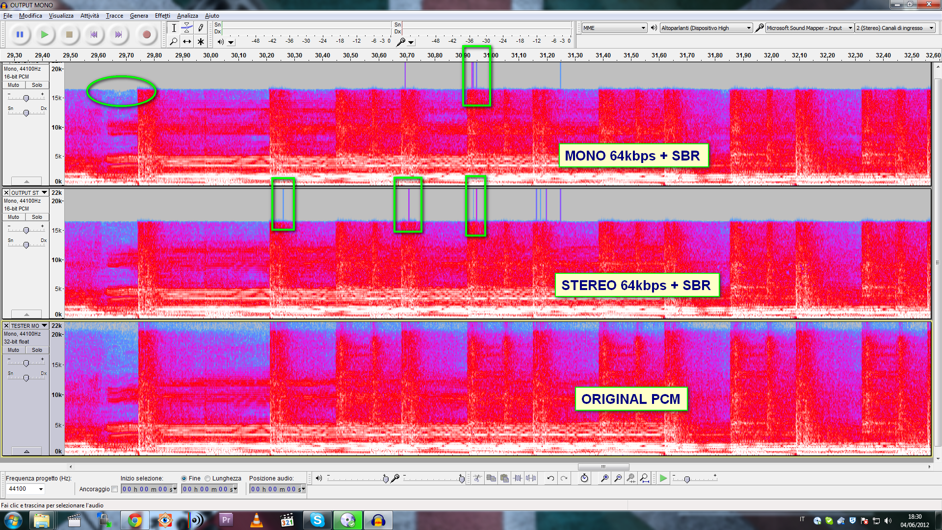

    I did a test to prove a quite simple fact. With lower birates, is better coding a mono track instead of stereo one...
    So I did a test using neroAacEnc.exe.
    First of all I took a sample mono wave/pcm file "mono.wav", then I doubled in two twin track (L+R) and I saved as "stereo.wav".
    Then I coded both file with neroAacEnc.exe with this string "-cbr 64000" ...it outputed two files, automatically coding in mono or stereo track looking into the source's properties.
    What is strange is that the stereo one is better than the mono one. In your opinion why?
    Did I miss anything? I attached all the samples...

  3. Well... I mean...
    1) I have an amount X of bits to be used (64kbps). If I encode a stereo track I have to use these bits to rapresent the double of uncompressed sound... I *suppose* it gonna be worse...
    2) No, I did two different tests. Starting from "MONO.wav" I encoded to "mono.aac". Then I made a fake stereo wave, doing a twin channel from MONO.wav and I encoded it as "stereo.aac"
    The image show the first "mono.aac" and one channel (the left I think) from "stereo.aac"..

  17. Ok, now sounds better... I forced SBR for both mono and stereo...
    Now graphs seem more legit ...anyway there's still a little loss of information on high frequencies, and lots of artifatcs..

    elmuz, your screenshots were better annotated this time and less confusing.
    You should ABX the results and stop looking at a spectrograph, though. The loss in those upper frequencies are above 15 kHz which majority of people older than 14 cant hear, and those blips you see at the top are tiny clipping errors (which spectrographs have a hard time representing) from your already-clipped Rihanna track that you probably got off Youtube.
    If you're concerned about the quality of audio, rate it with your ears, not eyes.

    ,a amplitude in file such as form
    tau, no of audio frame
    so you have a form that has a distribution such as the reds in picture
    any teacher in maths can add pi/2-tau+_deltaphase to pin harmonic frequencies so you get blue if that circle targets such harmonic form.
    a form may
    a(tau) =15.69231pix same with 32769pix precision in common waves w sign
    cosg(tau)= cos(ax+bx^2+cx^3+tau), distribution of clipp (3decibels)
    cosg(tau_0) = sin(m tau_0 +n tau_0^2+ timelength_in_mono_track/sampling_rate),
    so you target tau=tau(a,b,c) from my eq. cosg(tau_0)==cos(tau) and the maths i find
    tau = arcsing(m tau_0 + n tau_0^2 + timt/sr )\fraq{(ax+bx^2+cx^3)}
    as t =tau
    cosg(t)= sin( ax+6 bx^2+cx^3+t)
    and homogenise it down to
    Now lets find the harmonic freqvs. First circle should be a pole that has a minimum amplitude and maximum (red)distorsion. Measure the sample and find frequency 1/tau_0 star x. Time is x so 1/tau_0 is length samples_in_track.
    timt=1772frames
    lows_center=10.61538pix, în image
    ~highs_rest=15.69231pix,neighbor limits_left and _right sides
    I want to hear it so tau_0=35frames is audible and follows pole zero
    Interval in zero is 8frames long, that’s 20.92308pix.
    Lower audible freq 1/tau = 16hz ~ 16frames, true? Statistical in picture 35frames is:
    Frames hz_equiv pix_units
    1772 110.75 2363.077
    35 2.1875 same (46.6)
    8 (10.65143)
    so you may hear brown noise at playback. So freq I hear in 35frames eq 46.6pix
    At left side în circle find the derivate value d(_gtau)/ds for find core freq (one you pick as brown noise)
    d/ds (_ltau) = d/ds (cosg)(ltau) = do math = gtau_1eft
    that`s horiz_length_ for max amplitude cosg(gtau_left) and should read 15.69231pix. Lets check frequency at leftside of circle.
    Cosg(gtau_left) = do math > 46.6pix
    Gtau_left=(35-8)*1772/1920=27.91875pix
    Lets do it!
    -find deriv_value
    d/ds Cosg(gtau_left)= cos( ax+6 bx^2+cx^3+t) (a+2 bx+6cx^2+ ltprime)
    ltprime=[1/sqrt(1- (m tau_0 + n tau_0^2 + timt/sr)^2) (ax+bx^2+cx^3) - (a+2bx+3cx^2) arcsin(m tau_0 + n tau_0^2 + timt/sr) ]\fraq{(ax+bx^2+cx^3)}^2
    d/ds cosg(gtau_lef)=cos(u+[u\fraq{\sqrt{sing(uprime)}}+a+u` arcsin(uprime=1)\fraq{uu}]] = (15.69231 - 10.61538)\fraq{2.1875} = 2.321243
    made aproximations:
    u = ax+bx^2+cx^3
    u`=a+2bx+6cx^2
    uprime= m tau_0 + n tau_0^2 + 2.1875+2pi\fraq{2}
    2.321243=cos(u+[u\fraq{\sqrt{sing(uprime)}}+a+u` pi\fraq{uu}]])
    2.321243=cos(ax+bx^2+cx^3+[ . . .]+ (a+2bx+3cx^2)\fraq{ax+bx^2+cx^3-0.1} pi\fraq{uu})
    After replacing u,u`,uprime find gtau_lef= &gtau_right=
    Assuming (m_0,n_1)fit armonic to overlap în origins.
    X [pix] you may find m=m(x), let n=0
    So m_1=m(0.1pix)=0 and m_last=m(1771.9)=whatever < 46.6 tops
    if calculus is right someone find m(24.91875)= against
    d/ds ((24.91875 tau_0 +0 tau_0^2+ 2.1875)\fraq{(ax+bx^2+cx^3)+pi}) =
    = 2.321243
    24.91875 d/ds ((tau_0+2.1875/24.91875)\fraq{(2.1875 a+4.785 b+10.46 c)+pi}) =
    = 2.321243
    ds=110.75/2363.077
    e(a,b,0,pi) = 24.9\fraq{2.3} 2363.077\fraq{110.75}
    2.1875a+4.785b+pi=230.9966
    Ideally reactangle is half filled up for mono signals so a\cdot{b}=area\sqrt{2}
    Please compute colours height în pix în picture and find proficiency of AAC codec for that particular digital sound.
    b= (230.9966-pi-2.1875a)\fraq{4.785}=4.61873-0.457158a
    remember cosg(ax+bx^2+cx^3)?
    Cosg(ab0)=cos(a pix+4.61873pix^2-0.457158a x^2}]+c)=cos(omega_tau) that’s it
    You have tau_int_left=2/1920 1772/1920
    Tau_int_right=(1920-2)/1920 1772/1920 for the horizontal intervals
    The tau variab you find for the circle represents the samping interval with lack of rendering,în (pix,pix)coordinates,originating at (15.69231,46.6), please allow homework because 46.6originated from (35)not (35-2) that’s for future lesson, !no 15.69231!
    Amplitude in null area lacks sample_rates\cdot{sample_rate} number of frames (or pix) lasting (gtau_left,to,gtau_right)interval that’s 10.65143pix [1772/1920]units that`s a 170.4229hz low pass filtering
    Starting from the the right_side of the image mcad should find a similar result increasing maybe error tolerant epsilon. (simply try to replace 1772 with 35 and 35 and 1772 and tell me a result)
