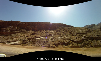

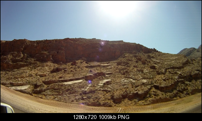

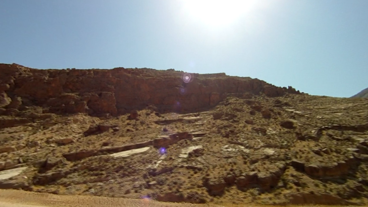

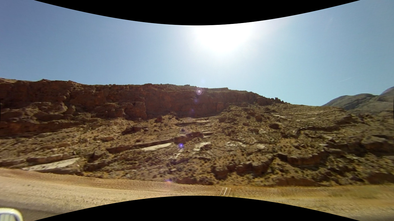

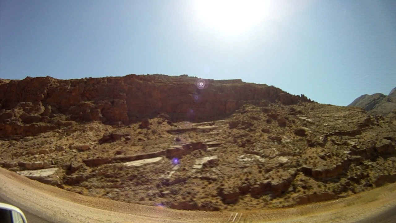

  17. Get the defish plugin
    LoadPlugin("PATH\defish.dll")
    FFMpegSource2("PATH\Fisheye.mp4")
    AssumeFPS(30000,1001) #this is because ffms2 sometimes gets the framerate slightly off
    ConvertToRGB32() #req'd for defish, I'm using Rec.601 for this example, but you usually use Rec.709 for HD footage
    defish(fov=85)
    Original
    Defish(fov=85)
    Defish(fov=85, scale=0.7)
    When you "undo" a barrel distortion or fisheye, you are left with "gaps" - areas than were never recorded. Most plugins will automatically "zoom in" to eliminate the black areas, but you're left with softer footage, and less field of view . You can use defish with scale to control the amount of zooming
    (Get the pun??? "Defish with scale" hahahha!!! )
    This plugin doesn't have an center offset parameter - in your footage the center isn't actually in the center, so the distortion and correction are skewed (notice the objects on the left of the frame are more distorted than the right)
    Other FX programs can actually motion track background objects like the ground to (almost) automatically fill in the gaps, and there are other compositing "trickery" that you can do (e.g. the sky is easy to fill in for this particular) - so you try to get the "best" of both worlds - less zoom in , and no black gaps
    Most people add sharpening afterwards (because the scaling and undistortion cause softness, especially on the periphery) - but the "ideal" way to do it is through a gradient - so objects in the center are less sharpened, objects in the periphery are sharpened to a larger degree
    Of course you have to fiddle with the parameters and settings to get best results
