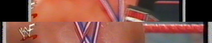

    I'm think what I did was very close to right. Look at the WF logo in the lower left corner. It's in the same place in both segments.
    Note, those are crops from VirtualDub's square pixel display so they aren't corrected for the pixel aspect ratio. But both are treated the same so you can see the logos are in the same place and about the same shape.
