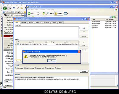

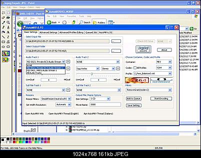

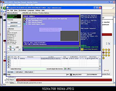

  1. Hi all , yesterday i have been here looking for answers to my problem here with a TS file i captured from a tv show .
    I spend all afternoon installing demuxers and remuxers , mpeg repairs and nothing went right here .
    I have looked also some other threads here with an identical issue and followed the steps but didnt went good for me
    First i wanna say that this ts file plays good on vcl media player without any faults .
    Anyway here it is a brief specification of errors i get using most programs here :
    Programs tested :
    Mpeg2repair -» cant get pids for audio and video on any programs in software
    Convertxtodvd4 - lazy conversion to mp4 but without sound also

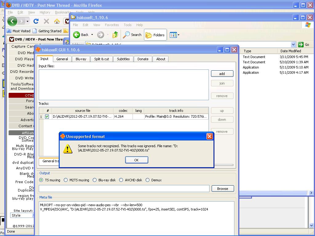

    Tsmuxer -» Message "Some tracks not recongnized , bla bla bla " i can get video output but no audio also
    hdtv2mpeg -» message "Could not find a channel"
    tsremux - I can get the video but no audio demuxed to m2ts file correctly
    xilisoft hd video converter - I can get the video conversion but no audio

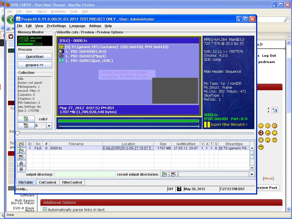

    Projectx -» cant touch it even change it to m2p , and gives errors on dgindex ,but shows the audio pid and video but says "picture decoding not possible no preview to mpeg-4/h.264"
    DGindex-» "No video sequencer header found"

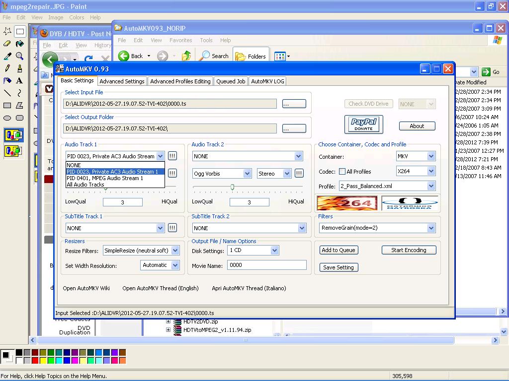

    Megui - » i do the updates then give me error on trying to open the main exe file witch as been renamed after the updates to --app !!!!
    AutoMKV093- shows the audio pids but when i try to convert them it stops with errors (never start the conversion)
    any ideas how to solve this problem ?
ID:	12595Click image for larger version
ID:	12596Click image for larger version
ID:	12599Click image for larger version

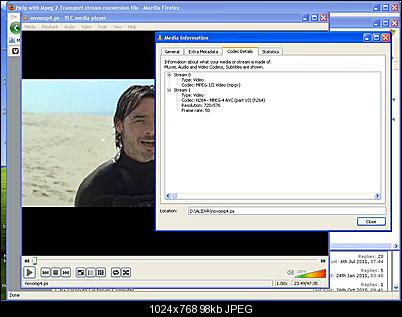

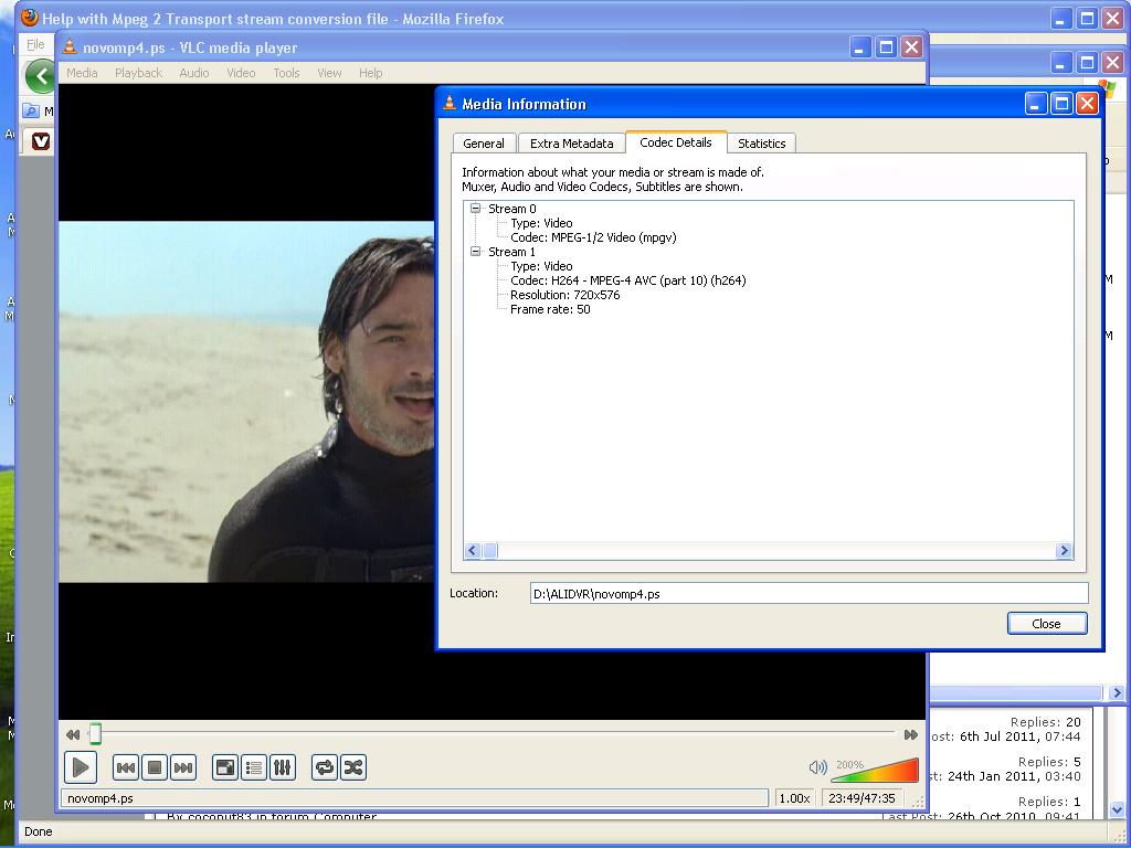

  4. strange , it converts as PS file , i converted it to mp4 and the program saved it as PS extension .
    I renamed it as mp4 and only vlc plays it , the windows media player dont touch it .
    I am trying to mpeg 2 conversion now , it is saving also as ps file the conversion .
    at the end i will rename as mpg to see .

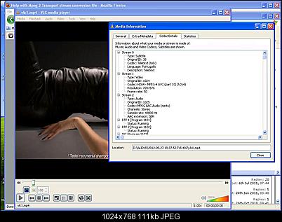

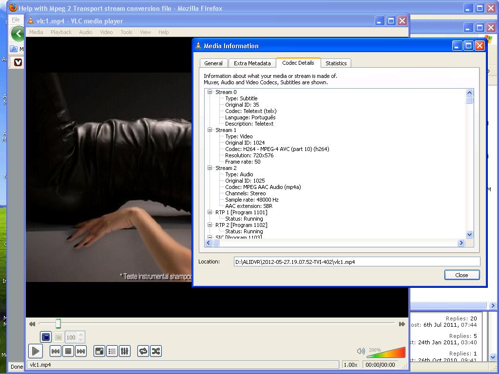

  5. ok , tested almost all formats conversion in vlc and result is that vlc grab the video but not the audio , vlc only bringa the audio using "dump raw data" witch creates an exact copy of the original file witch i cant use anywhere .
    Here are some infos on the codecs of both videos , the original and then the converted by vlc :
    this next info is from the dum raw data on vlc conversion witch made an absolute copy from the original :
    This one is from the conversion to mp4 i tryed to do with vlc but without any audio output :
    any klews to solve this people ?
    thanks a lot for the help .

    i am glad it worked for you. i am having a similar problem, my file extenstion is .TSV recorded from set top box.tried using it but error is video program stream not found.. its not playing even in vlc .only audio is playing and that too breaking. i tried converting with handbrake but it not even adding the file
    media info
