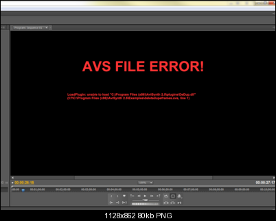

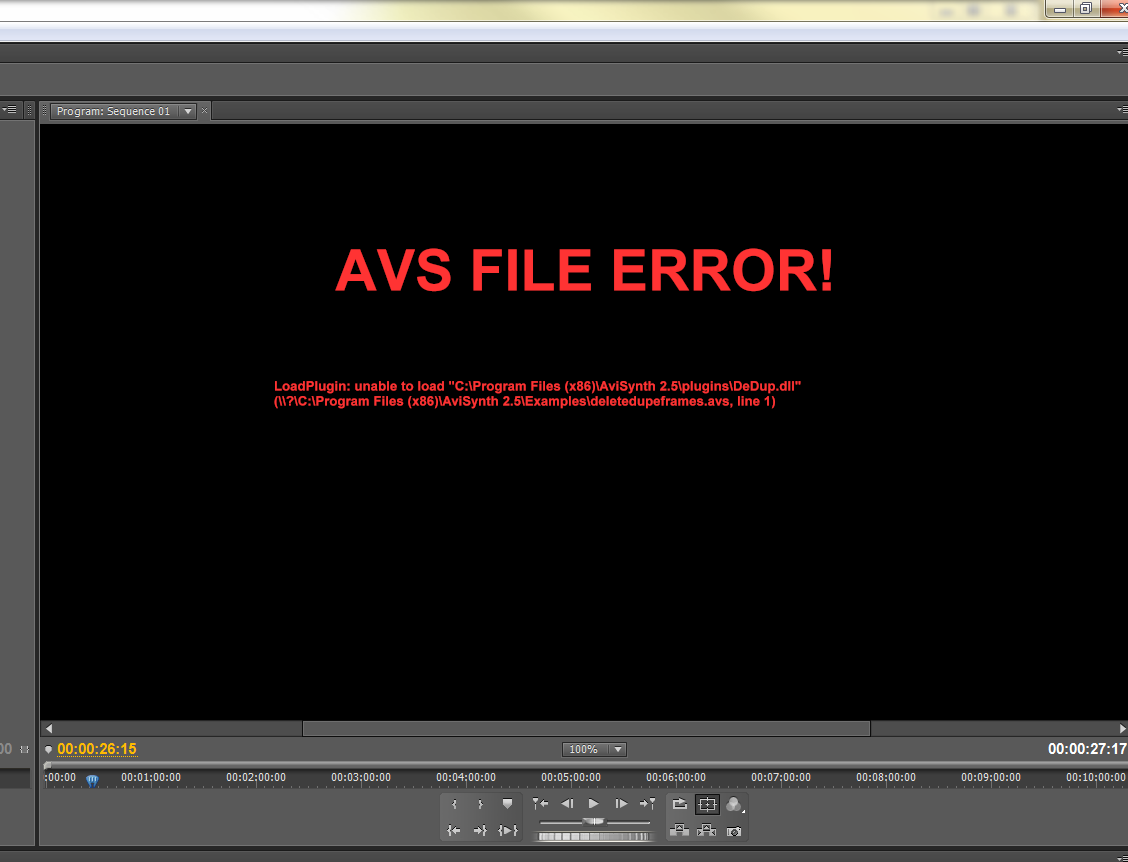

    Back to topic, I have managed to install the plugin but I get this:
    I don't understand thought, the path is correct but it still cannot locate the .dll?

  26. Poison please get to topic I don't want to discuss about hardware.
  27. OK fine, I'm just saying it's usually better to fix the underlying problem (for anything, not just video) than to go looking for other approaches..
    Did you run the pass in vdub ? did it give you an error message? Why is there a question mark in the error message for the path?
    (\\?\C:\Program Files
    Post your avs script exactly
  28. Thank you,
    I get the similar message in vdub:
    http://prntscr.com/9qjo2
    LoadPlugin("C:\Program Files (x86)\AviSynth 2.5\plugins\DeDup.dll")
    avisource("H:\DXTORY\test.avi")
    DupMC(log="log.txt")
    #DeDup(threshold=0.00001, trigger2=100, show=false, dec=true, maxcopies=20, maxdrops=20, log="log.txt", times="times.txt"
    And to show that its not a typo:
    http://prntscr.com/9qjuh
