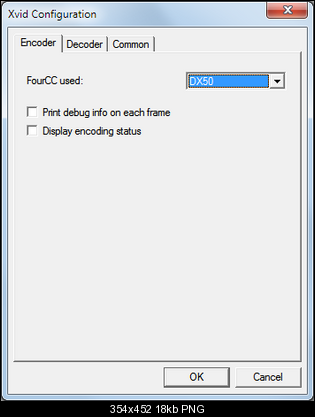

  6. Originally Posted by Shihab View Post
    Regarding fourcc, i don't know where to find it! I select Xvid Encoder in video settings...
    It's in Xvid's Other Options dialog.
    If your software doesn't give you access to that dialog you can set it via Start -> All Programs -> Xvid -> Configure Encoder. The codec remembers that setting in the registry so you don't have to set it each time the codec is used.

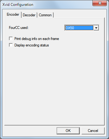

  7. Following your comment Jagabo, I had no Xvid configuration software installed on my PC, so i went and installed it. I found FourCC option within the configuration tool but it was shaded and cannot be changed. But even after installing this codec, nothing changed in the WinAVI software at all. It seems like it has its own encoding plugins and doesn't rely on any external sources.
    Anyway, along with Xvid configuration software that I installed, there was a utility called Nic's FourCC Changer, and since i got the idea from you that FourCC was my problem, so I easily opened it and chose my exported Xvid file and changed the FourCC to Divx, and that's it!! It worked perfectly.
    Thank you guys.
