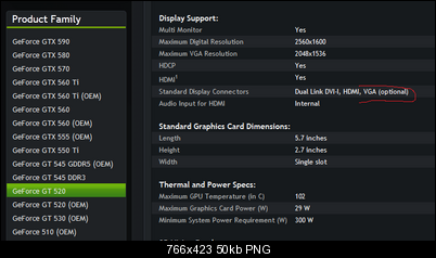

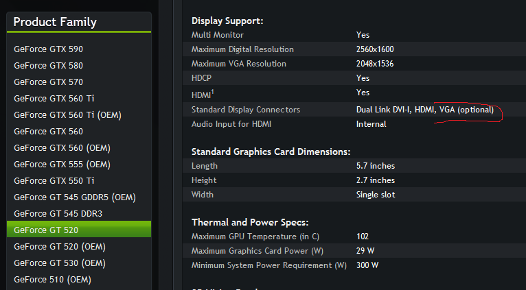

    The card has VGA, HDMI and DVI-I connectors. A DVI-I connector can support DVI-D and DVI-A (same as VGA) using separate pins.
    Most cards of this type support up to two simultaneous output connections (aka "Multi-Monitor"). The unknown is whether this particular card supports two analog VGA outputs simultaneously. This would require dual RAMDACs (output frame buffer to D/A). The card documentation should list the output combinations allowed. Alternately the tech specs should list one or two RAMDACs.
    Unfortunately the Nvidia spec sheet isn't clear on this. They only say "VGA optional". It isn't clear if the VGA connector is shared with the DVI-I port or if it has a separate RAMDAC.
    http://www.geforce.com/hardware/desktop-gpus/geforce-gt-520/specifications
    If the ASUS manual isn't clear, you should ask their tech support if two VGA simultaneous displays are supported.
