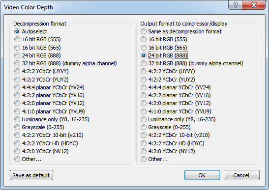

    I have 5 copies of VirtualDub 1.9.11 Build 32842 that default to RGB24 color depth output and uncompressed RGB. I often change those settings, but I never saved the changes as the defaults, which you said you had done some time ago. I would advise checking those defaults in full processing mode. We have a lot of newbies who post YV12/YUY2 sample captures that were cut in VirtualDub and posted as RGB videos -- and the users didn't even know that the color depth and compression menus exist until it was explained to them.

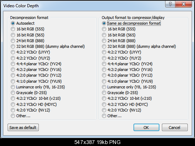

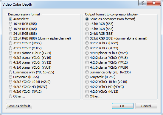

  29. I just checked (ran VirtualDub on a fresh XP install) and you are right. I thought the default Color Depth settings were this:
    But it turns out the defaults are:
    So indeed, if you've never set the Color Depth settings, Full Processing Mode will result in conversion to RGB.
  30. Banned
    New York, US
    That's what I thought. I just change them as I need to, but never clicked "Save as default". I suppose it depends on what's most convenient, but even then I have a habit of checking those settings anyway. Pain in the neck.
