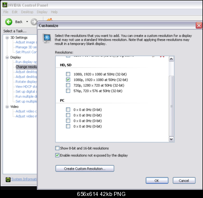

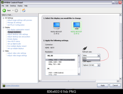

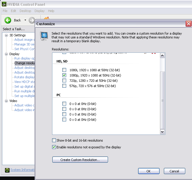

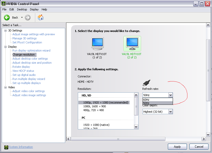

    Yes, I can demo the procedure for NVidia cards. The primary monitor is connected 60Hz (VGA or DVI-D in this case). The second out (HDMI) is set to extended mode (ATI calls this Theater mode). In this case I'm using a 1366x768 Vizio but it will accept 1920x1080p as an input.
    If 50 Hz doesn't immediately show as a monitor 2 option, set it up in the "Customize" menu as follows.
    Then when you return to the "Change Resolution" menu, 50 Hz is an option.
    Note that Monitor 1 and Monitor 2 are the same monitor in this case.
    In order to play a 50Hz file at 50Hz, one must drag the player window to the 50Hz monitor or set the player to output to monitor 2.
    With my PAL DVD test file, slow pans showed stepped motion on the 60Hz connection but were smooth on the 50Hz connection.
