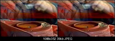

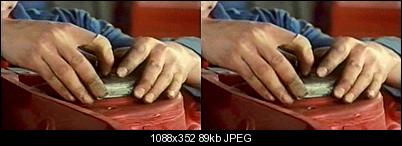

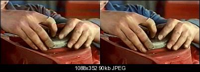

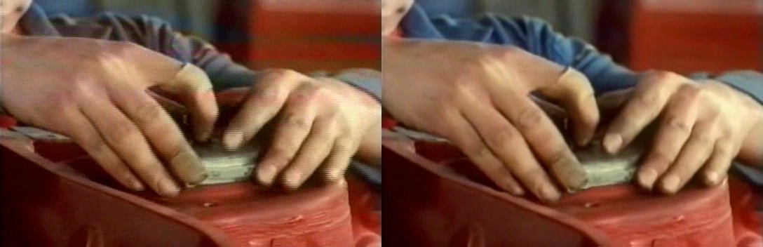

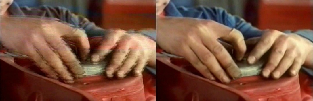

  3. Yes, the video was resized so the two fields have been blended together. There's no fixing it. You would need to go back to the original cap to have any hope. About all you could do is blur the frame on the vertical axis until the comb lines have disappeared. Then apply a little sharpening along the vertical axis. In the end, you may get rid of the comb artifacts but the picture will be blurry, look like a double exposure when motions are large, and the other defects will still be there.
    original on left, processed on right:
    BicubicResize(544, 118)
    Nnedi3_rpow2(4)
    BicubicResize(544,352)
    Sharpen(0, 1.0)

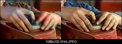

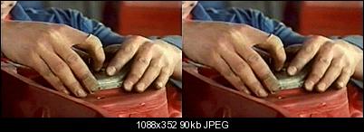

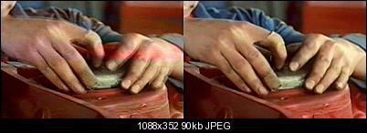

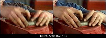

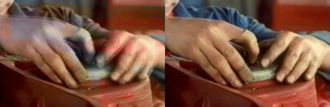

    You could do better if you're willing to put in a lot of time -- by replacing individual frames with either copies of nearby frames, or motion interpolated frames. But that will require going through the entire video, identifying which frames to replace, then adding commands to replace them.

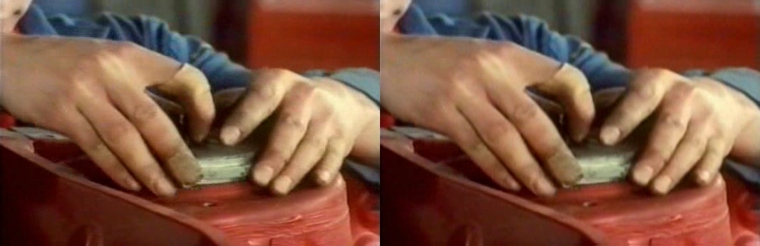

    Motion interpolated frames:

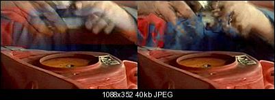

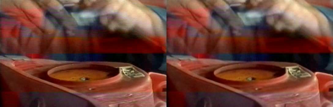

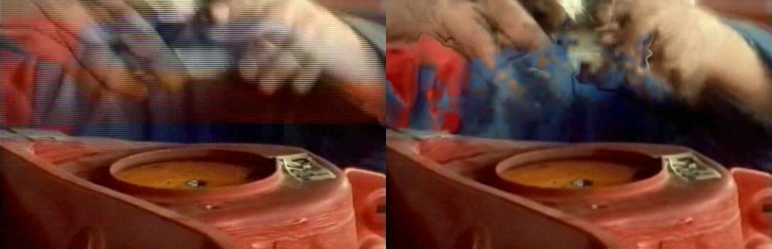

    The six frames in the middle were interpolated from the first and last frame. That was a case where the motion interpolation worked well. But it doesn't always work that well. A case where it didn't work well:

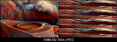

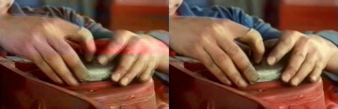

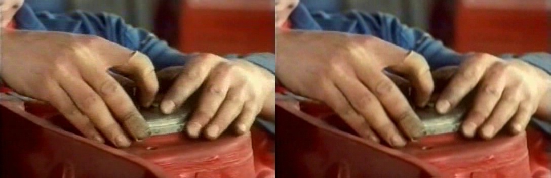

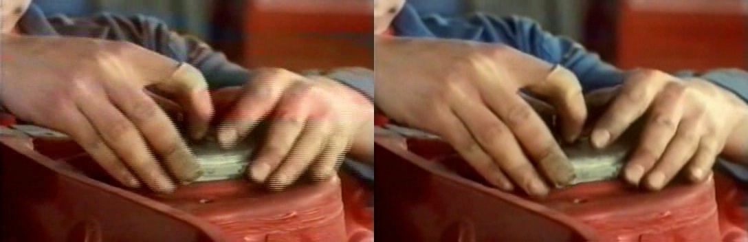

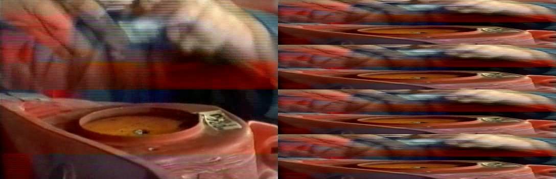

    Of course. But that video doesn't have two separate fields that you can seprate and recombine or deinterlace. The two fields have been partially blurred together. There's no way to separate them now. I have two numbers. The average of the two is 32. What are my two numbers? There 's no way for you to know. If you had completely still frames you might be able to restore the original frame by the technique you describe but it won't work with moving images. It's not as simple as every 4th line.
    Here's every 4th scanline as separate images (each 1/4 as tall). The original frame is on the left, the four stacked frames on the right. The top one is scan lines 0,4,8,12..., the next 1,5,9,13..., the next 2,6,10,14..., and the bottom 3,7,11,15... As you can see, none of them is clear of comb artifacts.
    Every 3rd line is a little closer but still no cigar.
    In addition to that, you the video was originally PAL and it was converted to NTSC with field blending. So there are many fields that are a blend of two PAL fields or frames. Then you have the time base problems which caused one field to jump up or sideways by a few dozen lines/pixels sporadically. And finally you have chroma blending problems. It's pretty hopeless.
