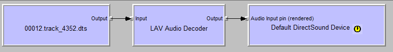

  6. Sorry I guess I got some of the names wrong, so here's an image to clarify:
  7. Hmm. I got it to work after all by changing the extention of the file from dts to dtsma. It went through the LAV splitter,then audio decoder, then directsound. But after loading the graph into AviSynth, even though it showed all 7 channels this time, it won't save the file (via SoundOut) as WAVEFORMEXTENSIBLE. I tried using OPT_UseWaveExtensible=True, but that didn't seem to do anything either.
    Hmmm, that's weird. Maybe it's a glitch in LAV Source Filter (which I never use, I prefer the File Source Async filter) --- OR in the version of LAV you're using ( I still haven't upgraded to the most recent one, because this latter has newer bugs and/or some regressions -.- )
    If SoundOut refuses to work as it should, then give a try to wavi.exe
