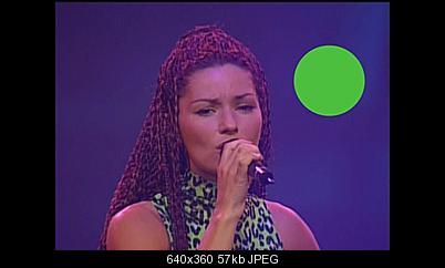

    1) Original pillarbox
Name:	1 Normal Pillarbox.jpg

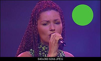

    2) zoom in = lose active picture area, also upscaling will make picture softer

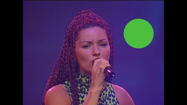

    3) distort stretch = make people fat
Name:	3 distort stretch.jpg
    4) the 4th technique isn't shown, it's covering the black pillarbox with something else, like a mirrored edge or something
