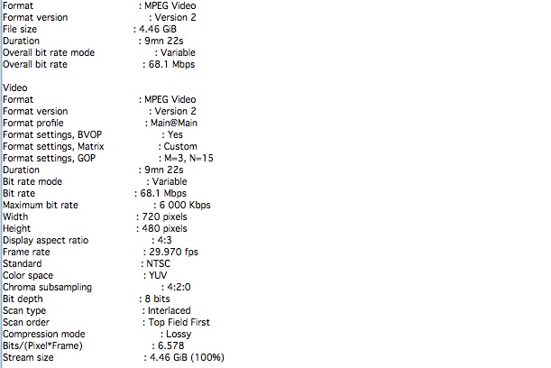

    Here is the info from mediainfo attached. Also, I'm confused why would it say 9 mn 22s when it's 2 hours and 39 min long? Thank you.

    Could the problem be that I may cut video using Avidemux in a place not right at the i frame and then not used an encoder that fixes this? (video was on copy setting)
  5. aBigMeanie aedipuss's Avatar
    Oct 2005
    666th portal
    could also be the bitrate is way too high. not much is going to want to handle dvd mpeg-2 at 68mbps. dvd spec is 8-9mbps to allow for audio and a 10mbps total cap.
