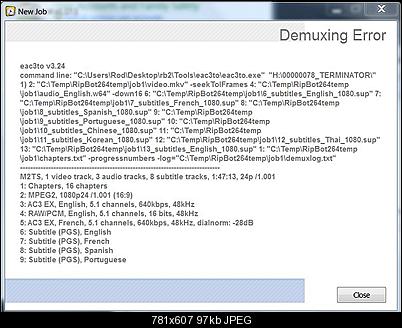

  1. 1.16.5 So I've been running 1.16.5 for a while nowith no issues and all of a sudden it hangs on "Demuxing Selected Streams... 1%" and never progresses
    so I tried using 1.17.1

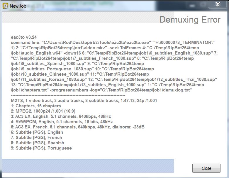

    1.17.1 This version starts off fine and then completely craps out (see Pic below). I saw some suggestions over at Doom9, and I removed all the codec packs, haali, avsync, etc. re-installed them but still no joy.
    Ive tried these with multiple BRs and DVDs.
    Anyone have any ideas? Because Im out.
    All help would be appreciated

  3. Ive tried re-installing all the codec packs, AVISynth, Haali, and ffdshow back to the way it was before and still no luck with either version. I even installed older versions of Fffdshow, and avisynth but to no avail... Im sort of stuck now.

    Okay.
    With the 1.16.5 version (as I learned this the hard way), you have to completely uninstall everything (Ripbot, all the codecs, and you'll want to run a systems check to make sure everything is removed). One verified, reinstall the codecs FIRST before reinstalling v1.16.5. And there's nothing wrong with installing the latest codec versions, either. As long as the codecs and program requirements are installed first, you should have no problem installing the prior version (just make sure v.1.17.1 is not installed... multiple versions of Ripbot on the computer cause the program to freeze or crash).
    Regarding the latest release, v1.17.1, I haven't had anything freeze yet. However, I have noticed an increased file size and choppy video on both the .mkv and .mp4 output on a CQ 20 setting, automatic, no resizing, full 1920x1080 at the highest 5.1 setting for either output (which may be due to the implimentation of 5.1 since I'm an audio hog). I don't know if anyone else has run into this problem, but this version on my system doesn't want to compress at all (Ripbot does compress, whether rendering to .mkv or ,mp4), so I'm ending up with massive file sizes with choppy playback (i.e. depending on the movie I'm backing up, normal file size for a standard BD falls within 2.83 up to 5.92 GB at full 1920x1080). This might be a codec issue I have yet to pinpoint, but if anyone's run into this and found a solution, let me know!
    The other thing I can think of (having had to do this with a few select titles), is you may need to remux the video and audio streams (TSmuxer is what I use)first, then import the new .ts file it into Ripbot.
