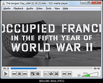

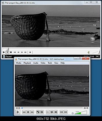

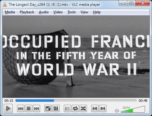

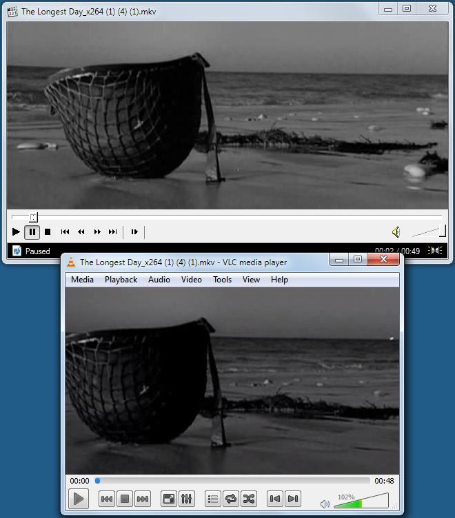

  14. I have created 49 second file 8.27MB.which is attached for your study.
  15. Attached is a remux with the MKV cropping feature. VLC obeys the crop setting (bottom), MPCHC doesn't (top):
    If that's not enough to dissuade you from cropping the picture, maybe this is:
    This movie was intended to be viewed as 2.20:1, you should watch it that way. As you can see, the director carefully composed the shots to take advantage of the 2.20:1 aspect ratio.
