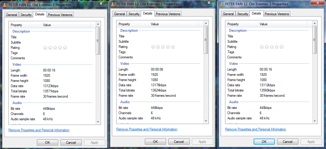

    EDIT: can you right click on the 3 files you have, select properties, and take a screenshot of the file details and post them up here (see example below)

  12. Member Daniel_BMS's Avatar
    Oct 2009
    They should all have the same properties as they all came from the same source and were created the exact same way.

  13. ahh, so this is 3 very short segments from the same bluray movie ???
    how did you get these 3 particular clips from the movie, like are these other features from the bluray that are not part of the main movie itself ???
