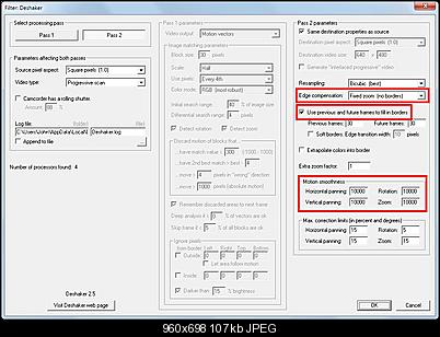

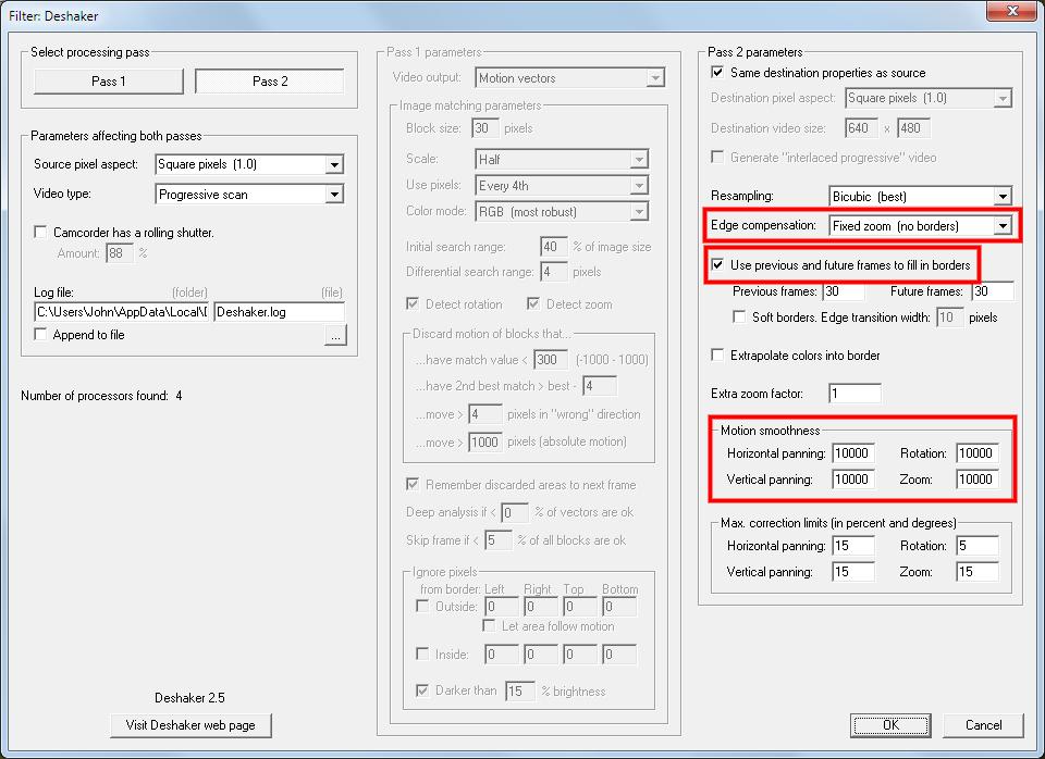

    I have installed the deshaker V3.0 to Virtualdub 1.9.11. If you add the filter, a large window opens with various settings. Can you post a screenshot about the settings you used to convert my file?
    After you add the filter, what do you have to do? In what format did you save the file? This part in Virtual Dub is still unclear to me. I would also like to create mp4 or other mpeg, my HDTV can only open those.
  4. The basic process of using Deshaker:
    1) Open Video File
    2) Add Deshaker filter, press Pass 1 button to enable the first pass, make any changes in the Pass 1 Parameters box (I used the defaults).
    3) Go back the main VirtualDub window and select File -> Run Video Analysis Pass.
    4) Go back to the DeShaker dialog and press the Pass 2 button. Make any changes in the Pass 2 Parameters box.
    5) Go back to the main VirtualDub window and preview. Repeat steps 4 and 5 as necessary.
    6) Select audio and video codecs, set them up, File -> Save as AVI.
    I don't remember the exact settings I used but they were something like this:
    I saved as huffyuv (lossless) compressed AVI then converted that AVI to h.264 MP4 with x264.
